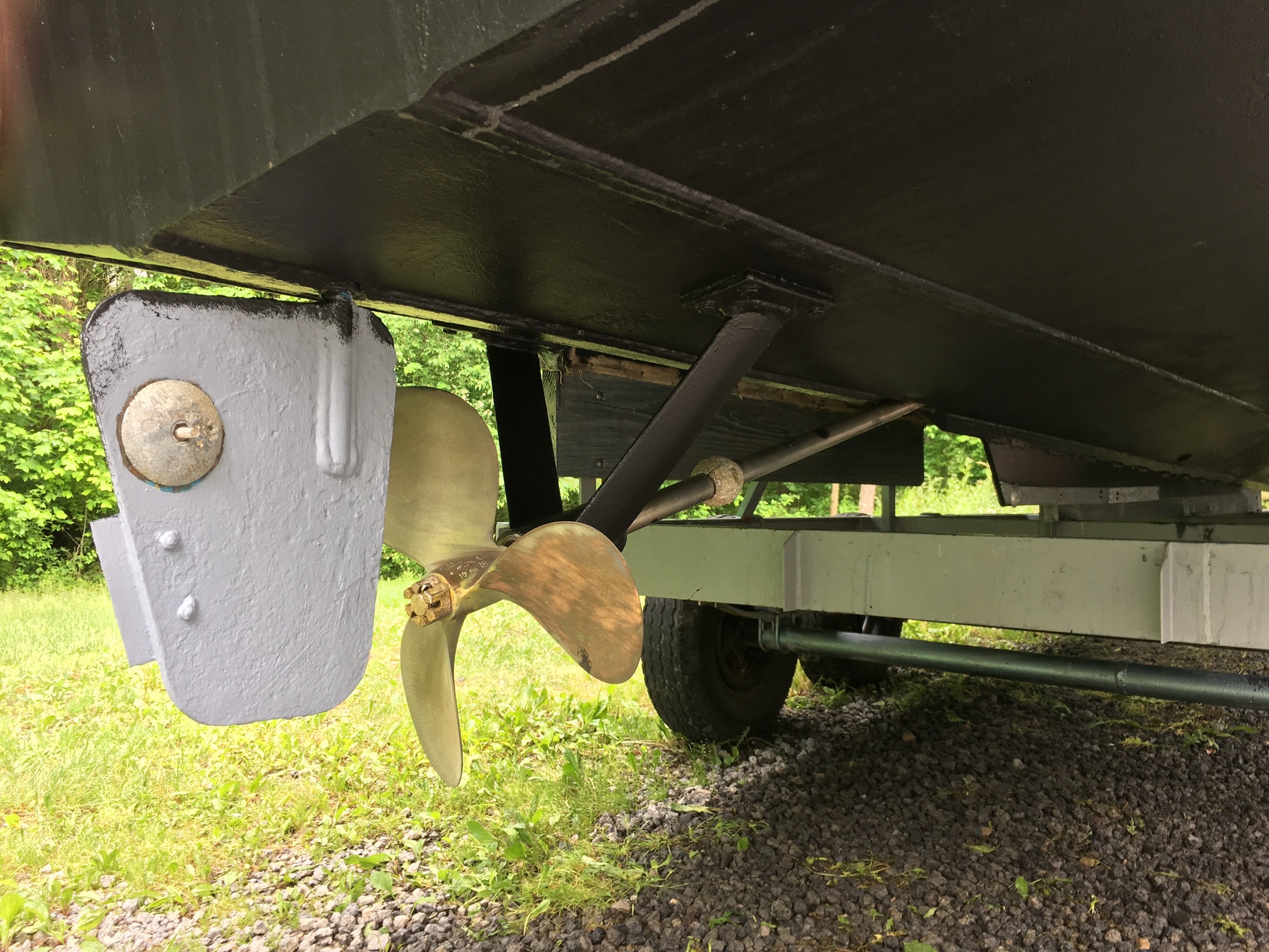

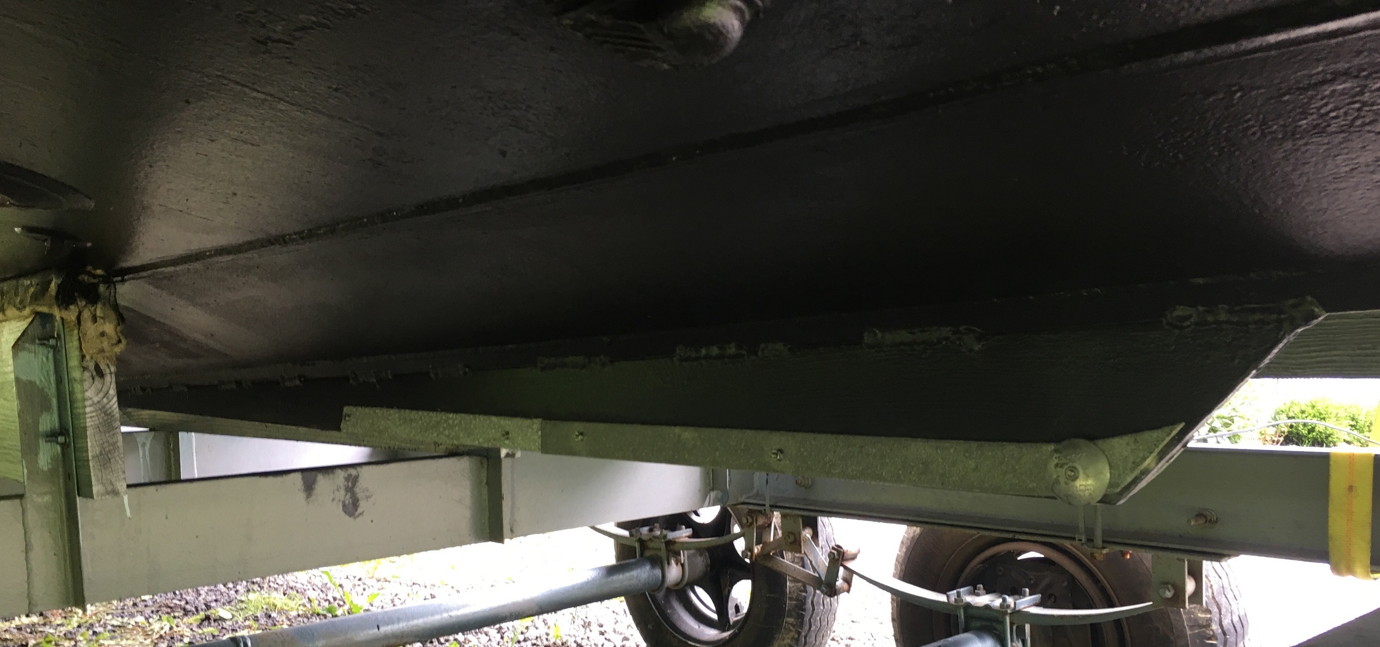

Postby shade2u2 » Wed May 16, 2018 12:39 pm
Most are like these. I have not seen a Marinette with anodes on the hull other than the Keel.
I added small disks as an experiment to monitor protection...
I should probably add one to the rudder.
TRIM TAB
RUDDER & SHAFT
KEEL
