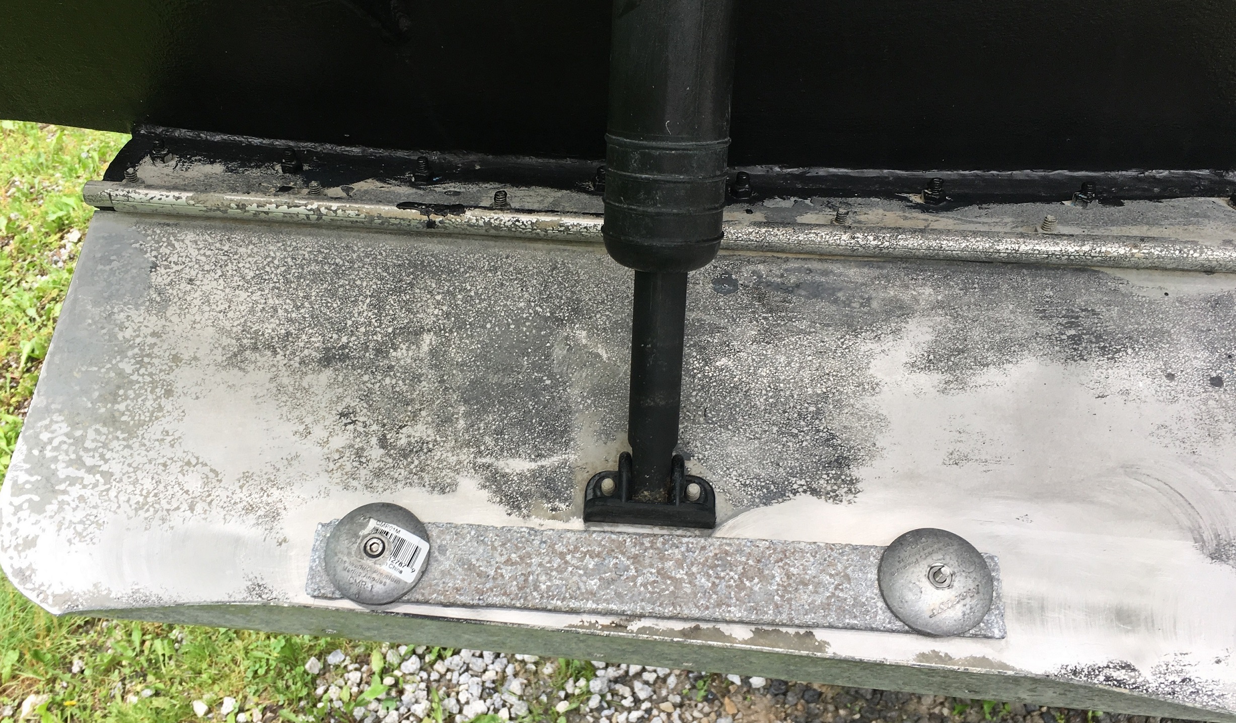

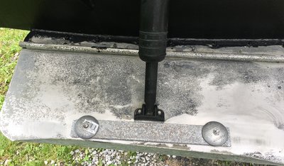

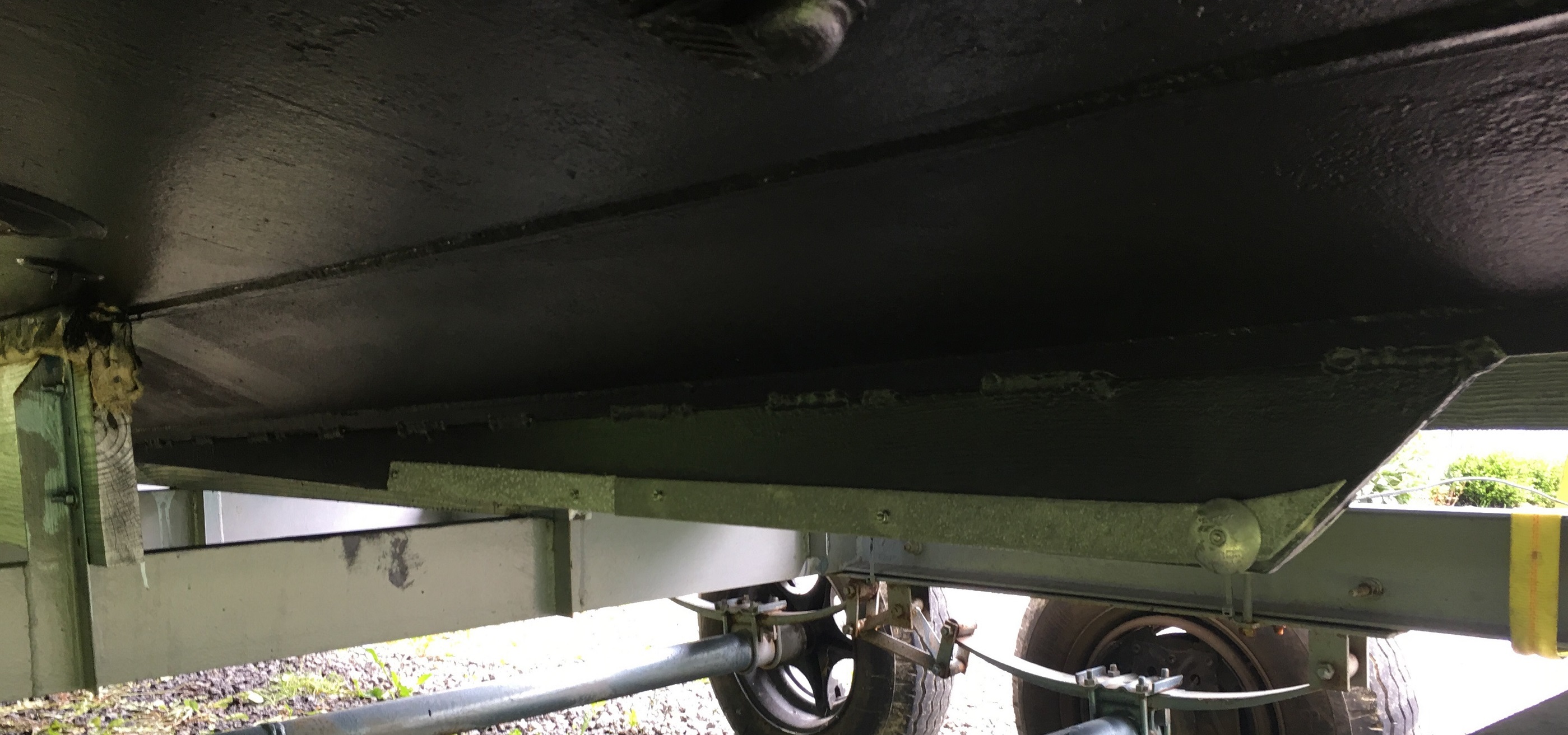

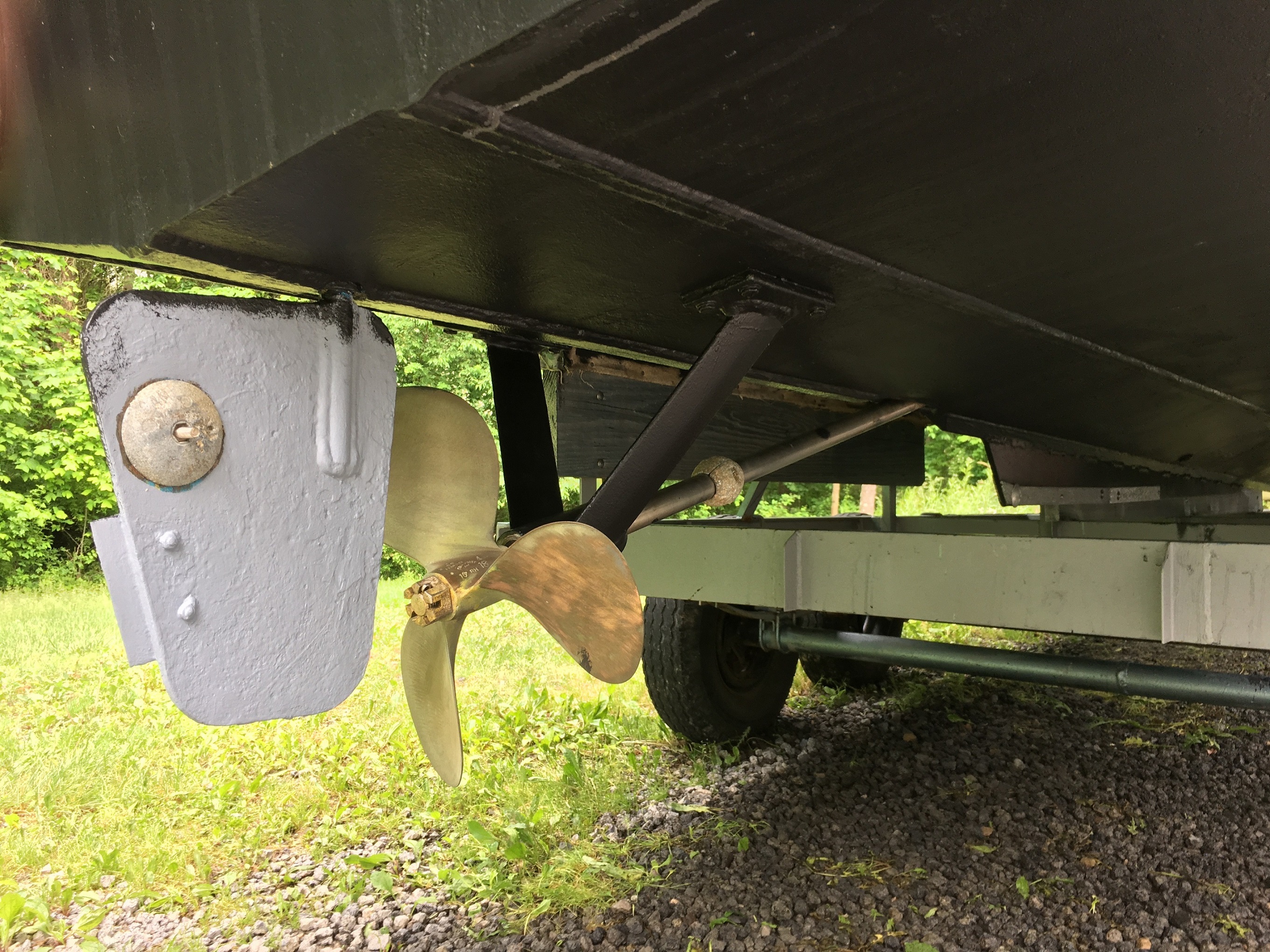

Most are like these. I have not seen a Marinette with anodes on the hull other than the Keel.
I added small disks as an experiment to monitor protection...
I should probably add one to the rudder.
TRIM TAB
RUDDER & SHAFT
KEEL

As noted above, and with photos, the points are keel, trim tabs, rudders, shaft (but really not needed if shaft is isolated).
