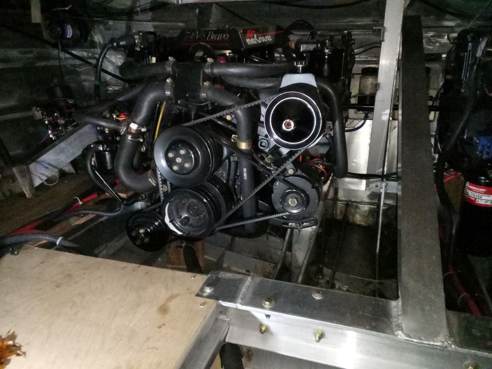

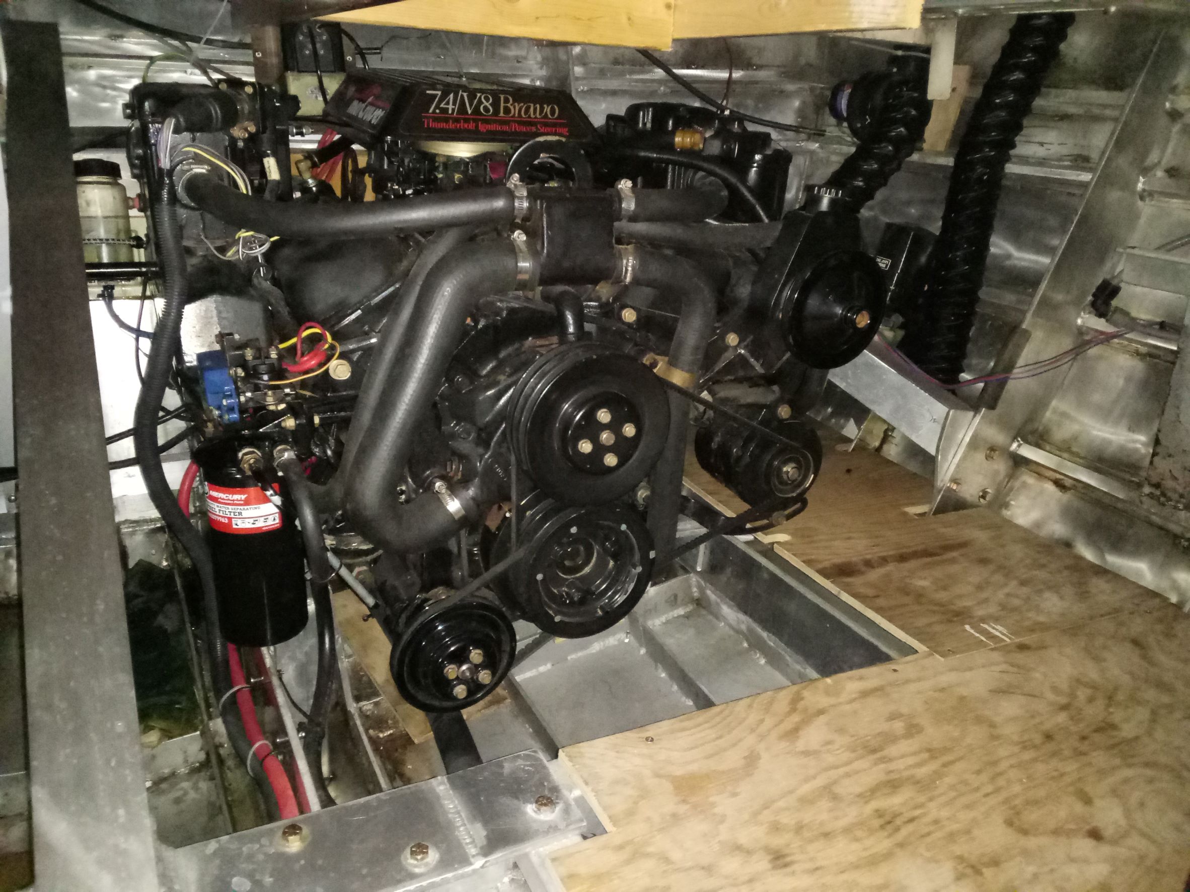

Made it to the boat to take a few pics of the 454's installed.
Rodney

Re: A little crazy?
You can see why outdrive power installations have become so popular--all that lovely usable space amid-ships.
Congrats for an exciting and challenging installation!
Love to see/ hear some video of her in operation!

Thanks Jeff, I still have a lot of improvements to go. But the wallet is quite empty at the moment, so I will slowly pick at it. I was hoping to get more done this past summer, safety and mechanical systems were first and foremost, cosmetics took a back seat. I have some re configuring of battery, tanks, electrical, etc., hoping to be able to get a chunk of it done before it hits the water this year. I didn't take any videos this past summer, I will try to do that coming up. It is definitely quiter with the through prop exhaust, which was one of my main reason for doing it.
Rodney

Those mercs look good in that space!
Like they belonged there all along.
Joe Napoli

Thanks Joe, that is what I was shooting for, To make it look factory. Although it would have saved me a whole bunch of labor and engineering if they would have just done it in the first place. :D
Rodney
