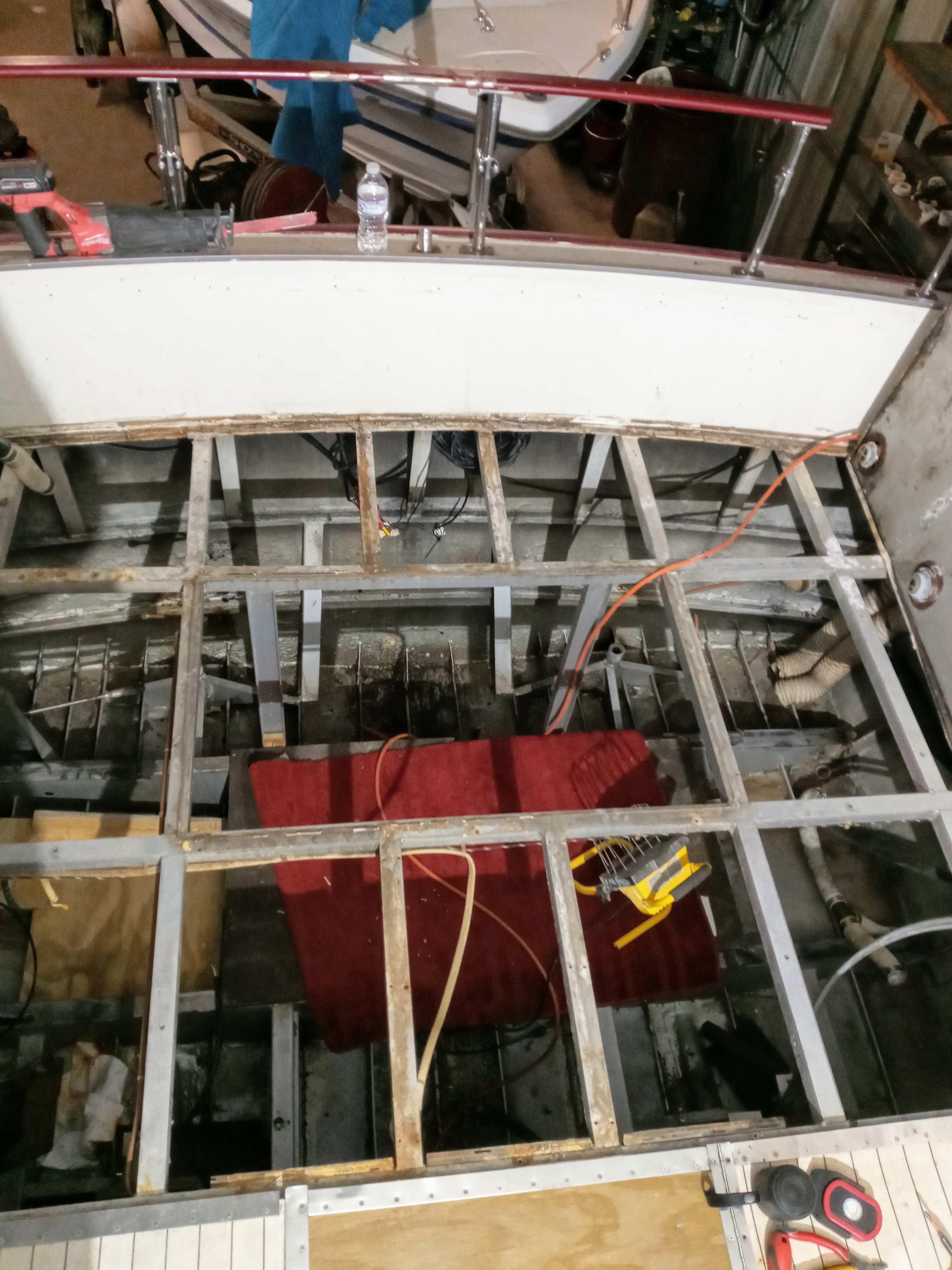

Got her mostly gutted! Waiting on material, and after it arrives, we will weld up the plates and start cutting some big holes in the transom!

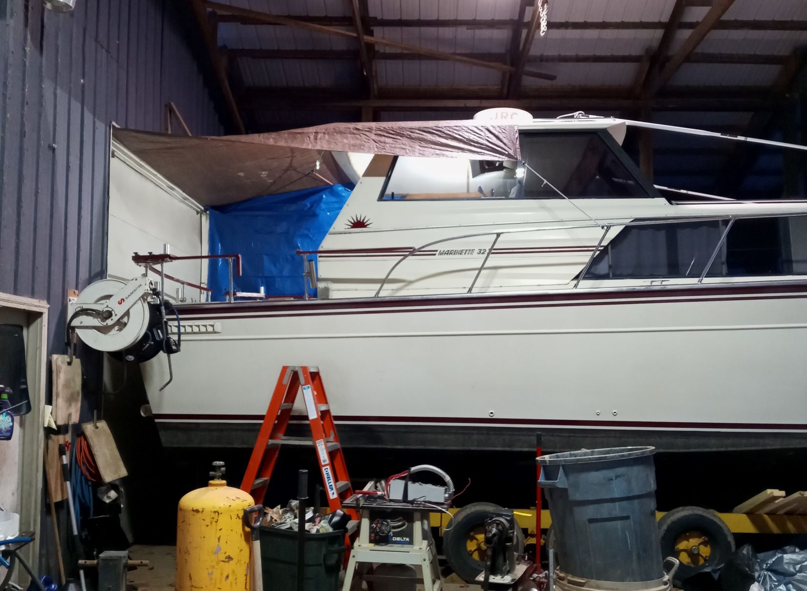

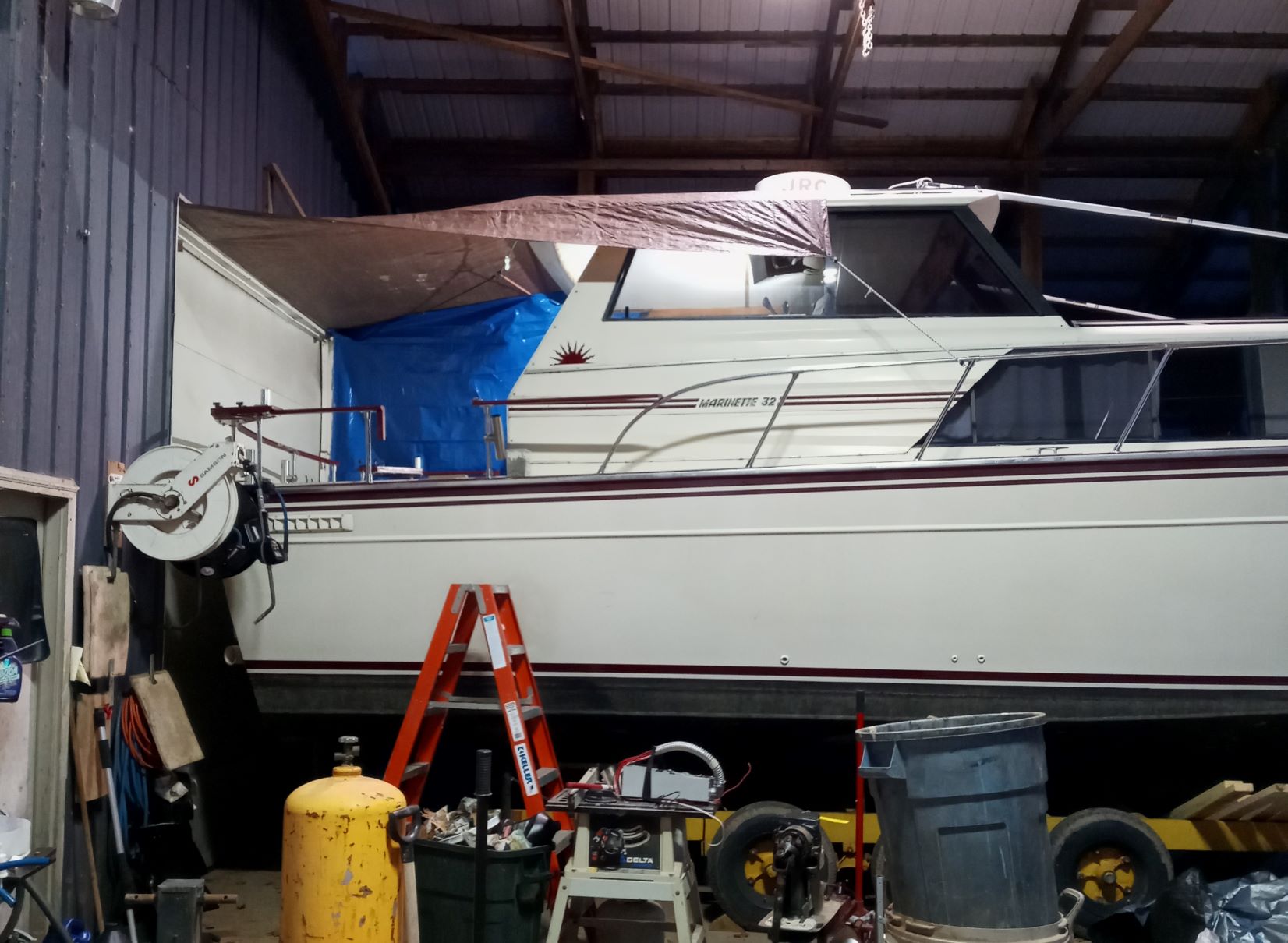

I have added more tarps, but as you can see, I started to seal off the rear so I can roll up the garage door behind it and stay relatively warm. It was -2 degrees here this morning. I will wait until it gets back in the 20's before I do anything more.

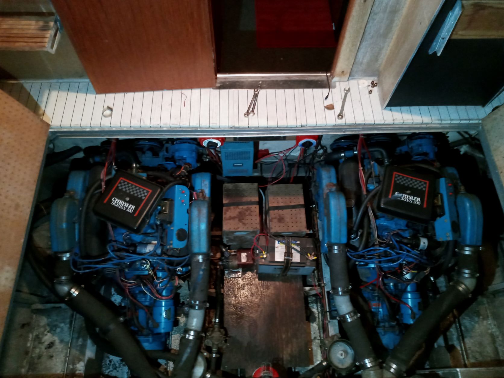

Last time the 360's will be in this boat?
