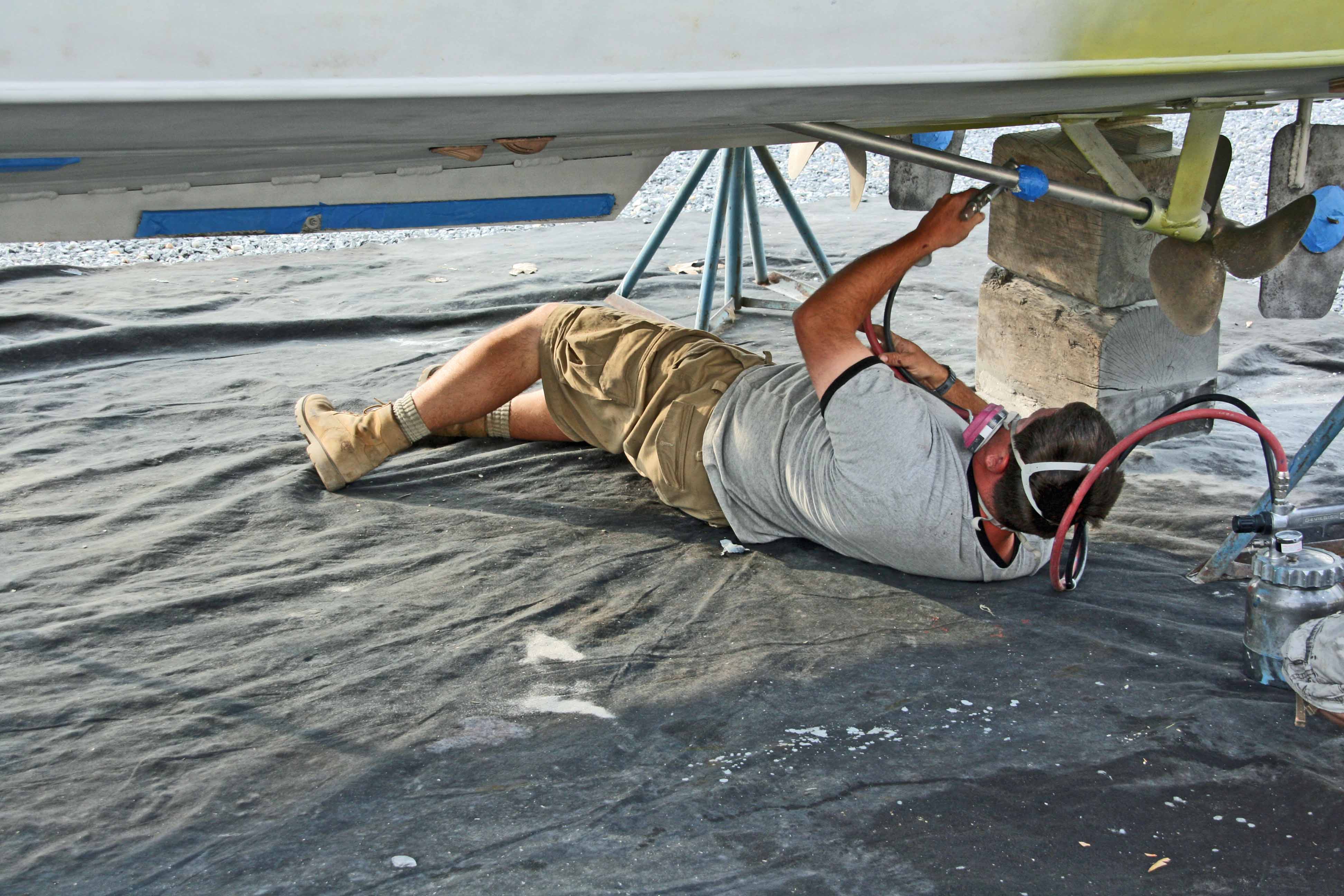

Picture, please and we can clear this up in a flash. But from your desciption, it sounds like it sure is a part of the boat. I am attaching a photo of my former '32 showing the last few feet of the "fin" (a keel stabilizer integral to Marinettes) when I was having the bottom blasted and repainted. It has a piece of blue tape covering the zinc strip over on the left side
Re: keel fin
No pics at this time. Joels picture shows the fin that my boat has. I'm now convinced it is factory. Yes, the anodes are bolted to it. It is going into very warm salt water. But, the boatyard guy, who has restored a Marinette before, advocates deleting the fin, welding six aluminum plates to the bottom of the hull (two forward, two mid-ship, two low on the transom) and welding sacrificial aluminum anodes to these plate. He says that is the best electrolysis protection to be had.
