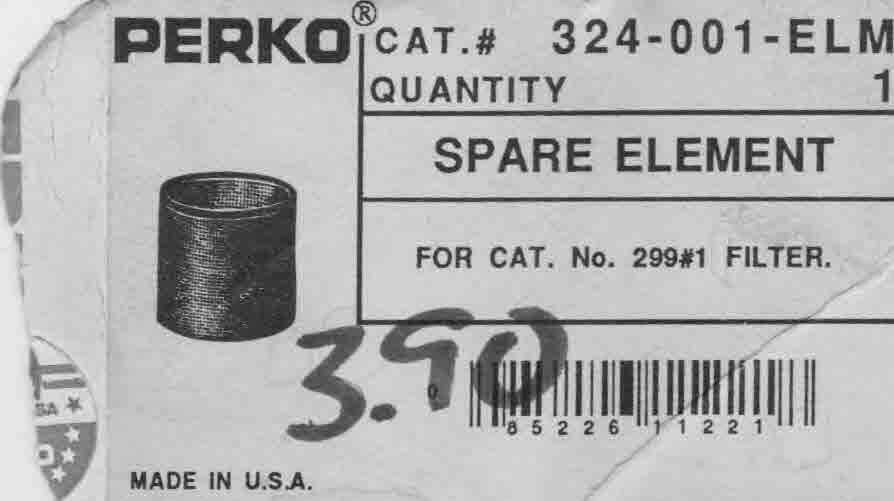

For those of you who have the old (but still very effective) Perko fuel filter with the ceramic cartridge, I attached the label giving you the part number when they eventually become harder to find.. (and now, having posted it for posterity, I can throw out the label)

Thanks for the info, as I'm always on the look-out for the hard to find/obsolete parts. If your boat is equipt with these filters and you cannot locate a set, they are cleanable. Provided they haven't deteriorated to the point of needed to replace, that is. Mine is a 1975, and I pulled them out (probably the first time they had ever been out) and was lucky they were still fully intact, but...they were nearly plugged shut with rust, gunk & debris (the filter housing was 1/3 full of water !!). Honestly don't see how she ran. Not knowing where to look to even find them, and wondering if I would have to update them to a newer style filter. I went to my local parts store and bought a one gallon can of carb cleaner, the one gallon can that you can actually drop entire carb in to soak. I dropped both elements in there for a couple days, and they came out looking like new. NAPA sells the one gallon cans in its Mac's line, #6402, and Gunk Automotive products sells it too. Hope this helps.

Wonder if you could just spray the filters with carb cleaner to clean them out? I may try it this weekend.

You can clean them with carb or brake clean, just spray from the inside out.
