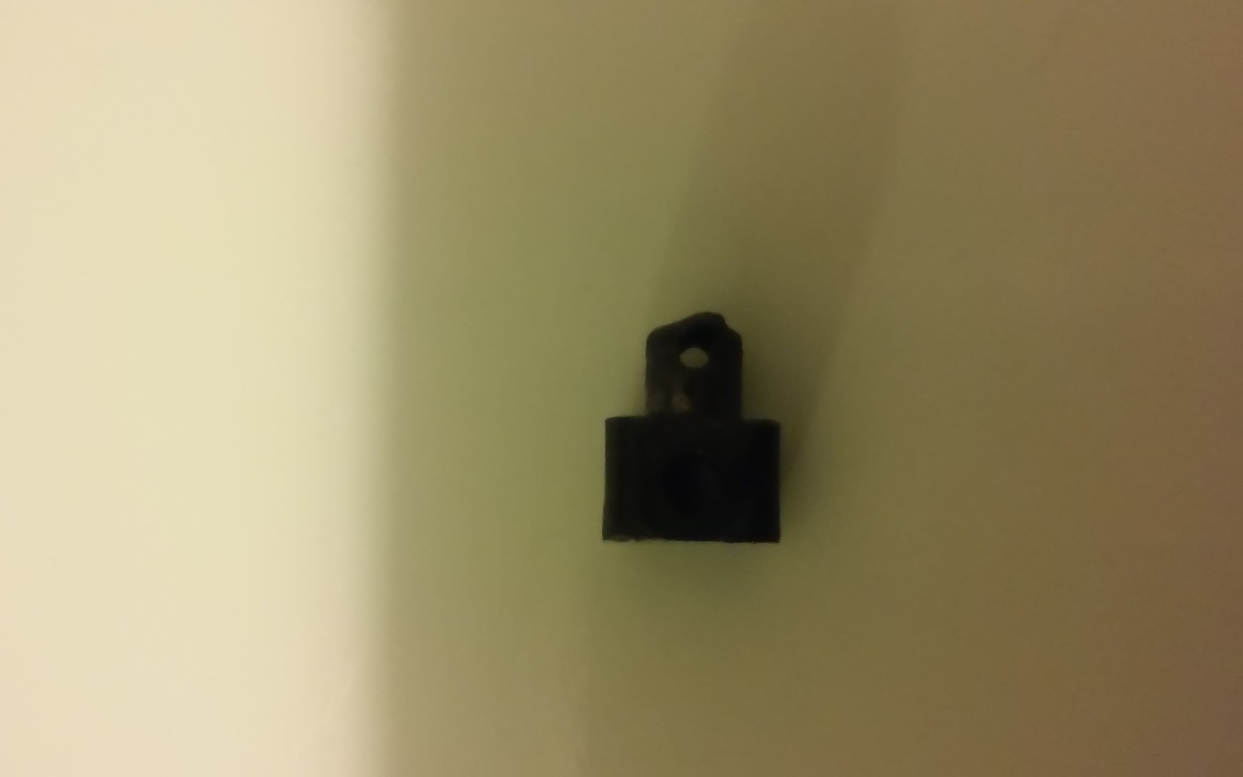

Ok....so I went up and pulled the cables down from the bridge and I do now have the numbers from the cable and know what to order for replacements. BUT, this leads me to another question. What broke was the small, black, plastic piece that connects the cable to the bottom of the throttle assembly. I have saeched around but am unable to find this small part. Any suggestions? Or am I likely going to have to buy a new Morse throttle assembly and just replace the whole thing?

Re: Broken throttle cable connection
Hers a pic of the part in looking for.
Any of the ones I have seen have been made out of brass. Where ever you order the cables from should be able to order the cable end.
