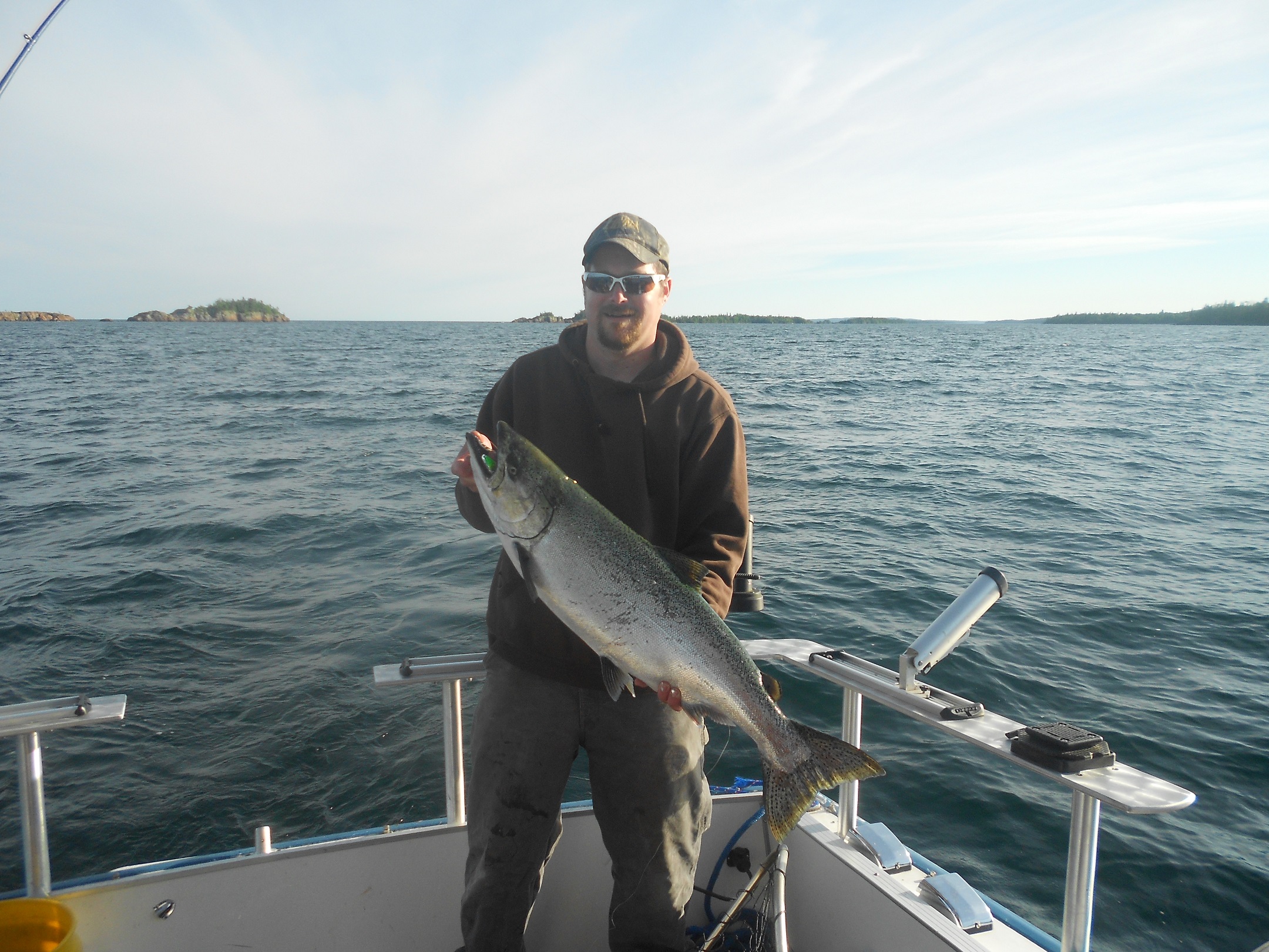

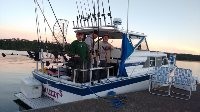

I removed my rear rail this spring. I cut out a 20" section in the middle to better access the swim platform. I then took the rail to a local welding shop. I had them copy the radius of the two halves, and then made new rails out of 1/2" aluminum plate, 6" wide, so I could mount downriggers and tracks for rod holders. I also had them make me 8 - 1 1/2" aluminum tubes with 1/4" plates on top and bottom to replace the old stanchions, 15" tubes plus 1/2" for the plates for the height. I also shortened up the sides a little, to make it easier getting on and off the boat. After I got it back from the welder, I used an air grinder with scotch brite pads on it to add swirl marks as a finish and to cover up the nicks and scratches from the manufacturing. I was complimented many time this summer on how it turned out. I also installed a Great Lakes Planer rocket launcher on the hard top to get some of the extra rods out of the way.

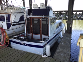

I removed mine when I restored the boat and rebuilt sole

Here are a few pictures of the rear rail that I had made. 1/2" aluminum plate matching the original contours of the original rail, I also had 1 1/2" pipes with 1/4" plates on top and bottom for the stanchions. I think it turned out quite well. Disregard the 21 lb. king salmon, it is only in there because of the railing.
