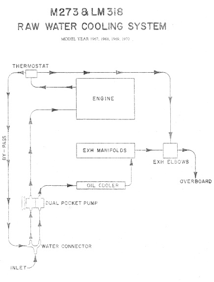

The single inlet water pump should be an engine with a closed (fresh water) cooling system. The dual pocket pumps are used on open (raw water) cooling systems. There was two versions of the raw water system, one with a mixing tee on the inlet side that hooks to the t-stat bypass, and the later one has no mixing tee and bypasses into the exhaust manifold. The later one does not use water outlet tube in the exhaust manifolds. The early one does. The early engines used a (now obsolete) screw in t-stat. Chrysler plumbing diagrams suck. They don't distinguish between outlets on the t-stat housing. Pictures might be good to determine what you have.

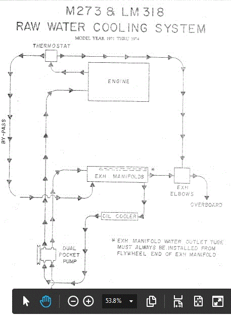

Ok I have this from Marysville marine and its a little better than the manual ive seen. My big question is the main line coming into the back port as shown. I took photos but they did not come out good enough will be working on it again this weekend.

It is interesting that the factory diagrams you posted show the water tube in the manifolds only on the non mixing tee system. If you look at the papers supplied with the new barr manifolds, they show the opposite. I have only had good luck doing it the way barr recomends. If I follow what the chrysler manual says, they run hot.
