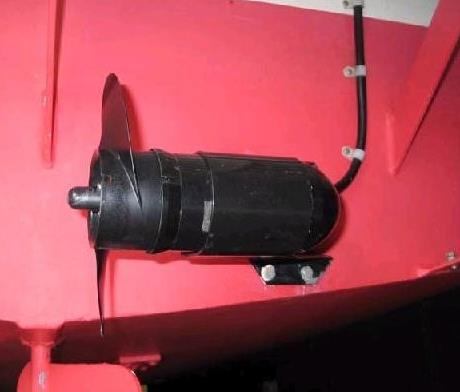

This Lewmar 140TT is on my stern...
Lewmar 140TT
Lewmar 140TT
Lewmar 140TT thruster.jpg (38.75 KiB) Viewed 18925 times
