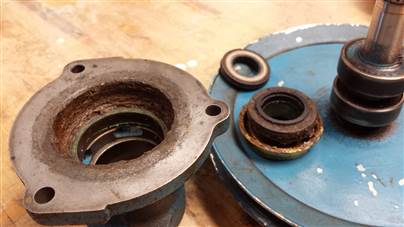

Pump was leaking. Tore down.. time was not good to her.
Was leaking around shaft got to bearings and pulling air around shaft causing cavitation.
Mr. Port I am sure is not going to be much better after 28 years and no rebuilds.
I noticed increased bubbles in strainer at spring start up. Been down that road before. Then I found the leak replaced impeller and it did not improve.
