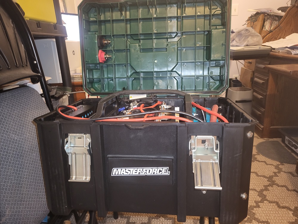

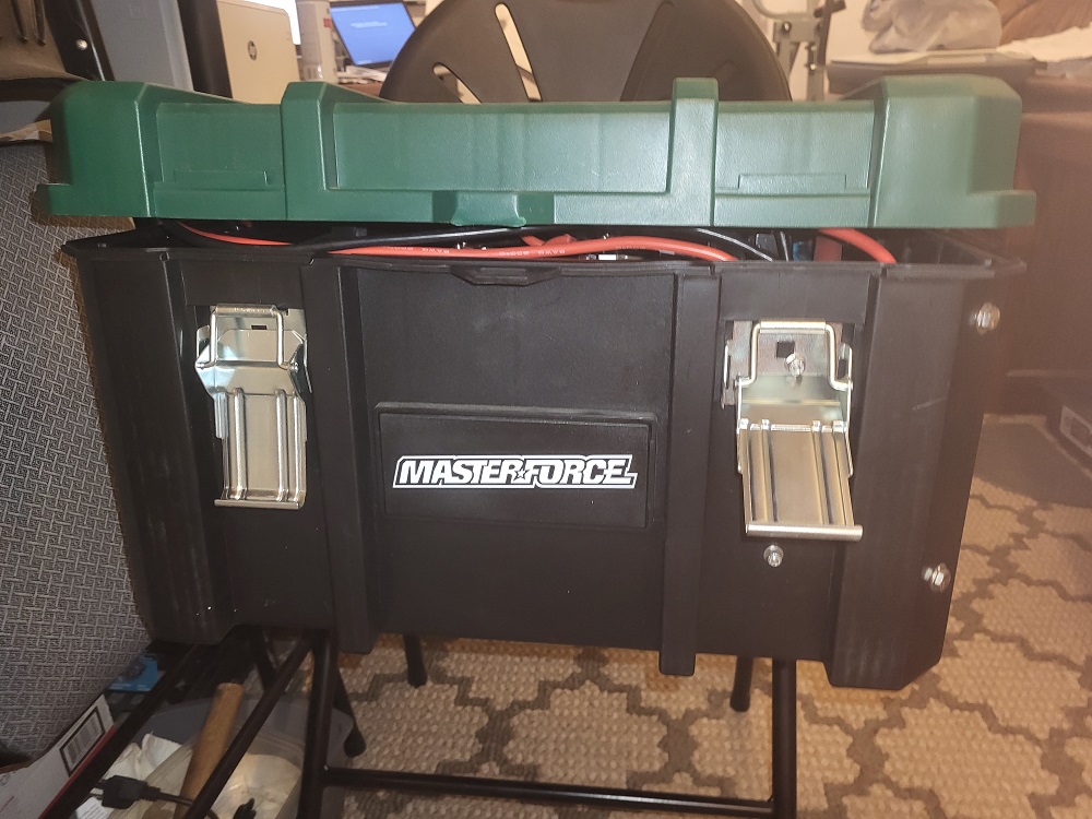

1st pic -
Frontal view - lid closed
Used the largest tool box offered by Menards.

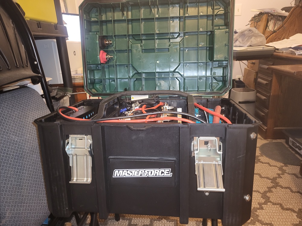

Posts: 537
Re: LiFePo4 battery build
2nd pic - Frontal view - lid open
Note battery connection lugs in lid (left side). 2-0 AWG battery cables will run to inside connection points to the appropriate ( + or -) bus bars. Outside lugs will have 2-0 AWG cables running to Xantrex 2000w inverter/charger's DC Input connection points.

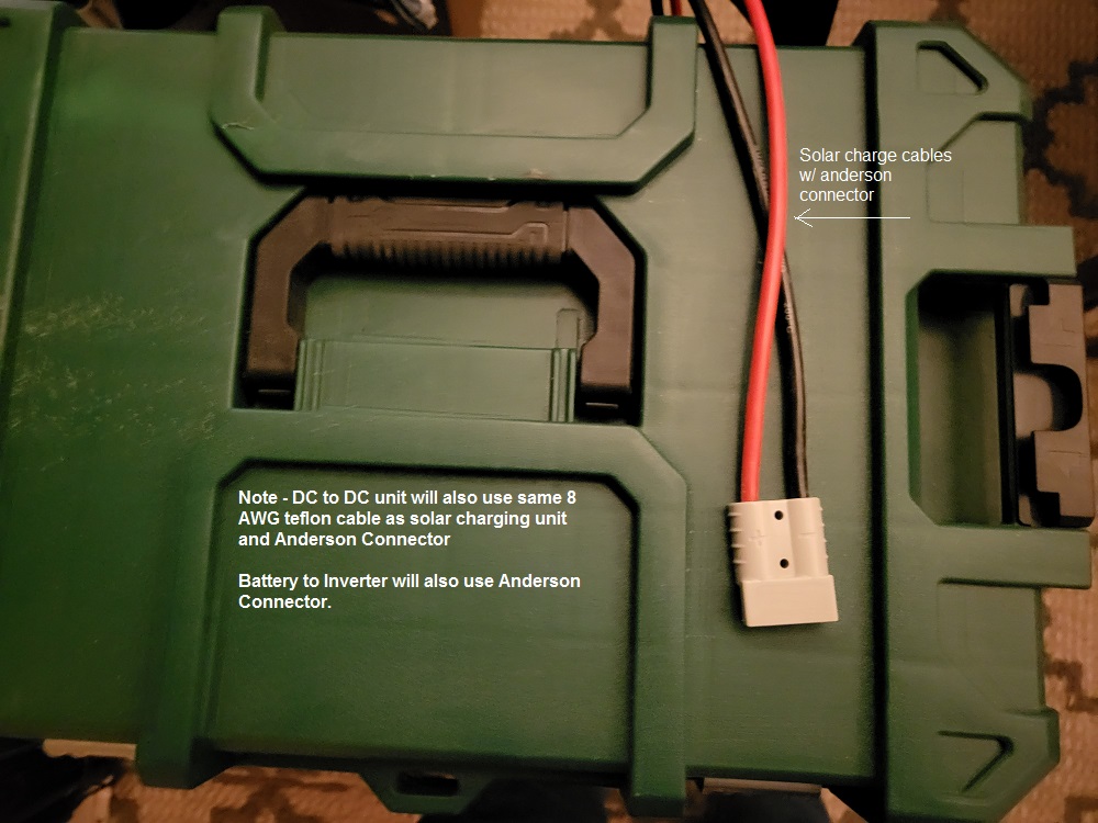

3rd Pic - Lid overhead view. Solar charge cable & connector.

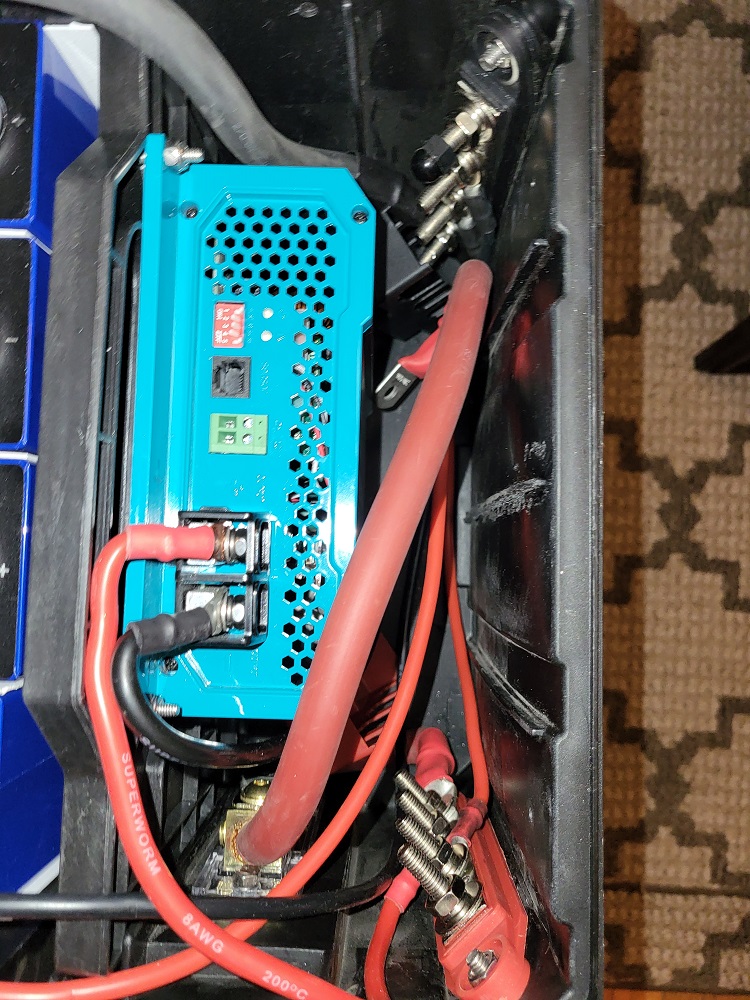

4th Pic - 20A DC to DC charge unit & Pos & Neg bus bars.

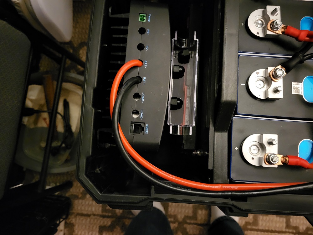

5th pic - BMS (Battery Management System) & Solar Charge unit.

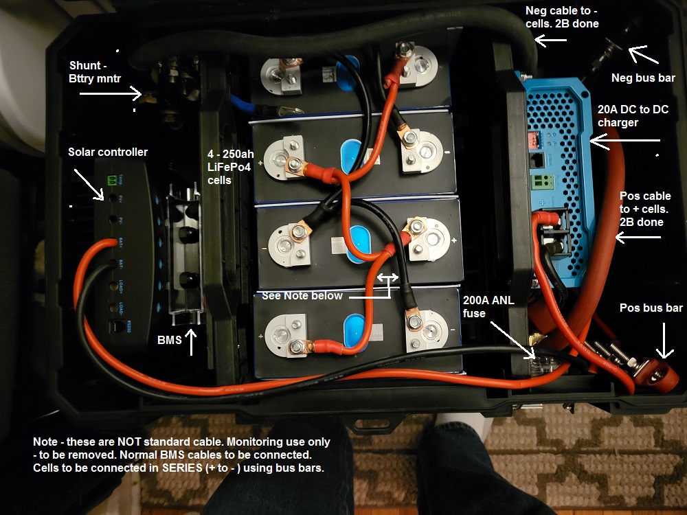

6th pic - Overhead view - lid open - overall with text details
