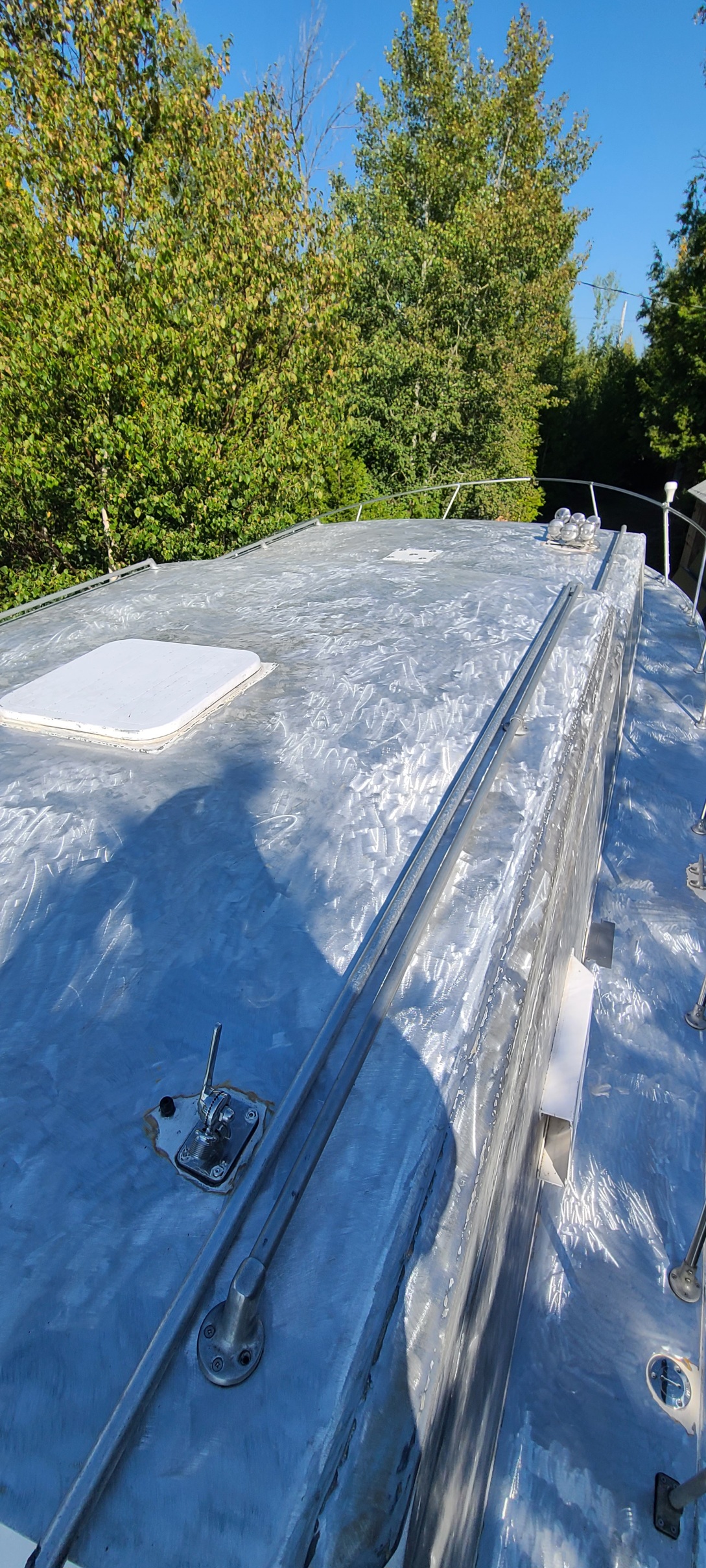

I am 2 days in, and I have the roofs and sides of my Marionette 32 sanded. It is going quicker now. I tried an angle grinder and flap disk, which instantly gummed up. I tried a SS wire wheel, which worked great, but fell apart quickly (made in USA 40$, wore a welding hood). I tried a belt sander, which gummed up, and fell apart quickly too. I tried wetting the surface with the belt grinder, and the belt fell apart quicker. I then tried the angle grinder and 60 grit flap disk, and a hose of water. That seems to be the winner. I did the whole top with 1 disk. I then found a 40 grit disk and switched to that. Much better. I can push as hard as I want, and no gumming up.
About 8 years ago, I had no time, and lightly sanded, and put on some Brightside. That is now horrible, and cracking. The original off white paint was also cracking, so I felt it needed to go. The orange/toffee primer seemed mostly good, but getting the paint off and leaving the primer did not seem practical, or a great idea. The paint guys really wanted bare aluminum. The Brightside paint sands off super easy relative to the original (I think) off white, which makes me wonder about Brightside.

Pics or it didn't happen.. it took 4 days, the first was really no progress, just learning. I will need another day to take all the fittings off, and re-sand for painting. Hopefully I can find a week this fall.
