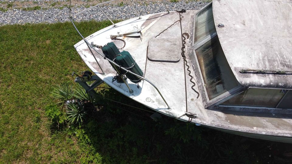

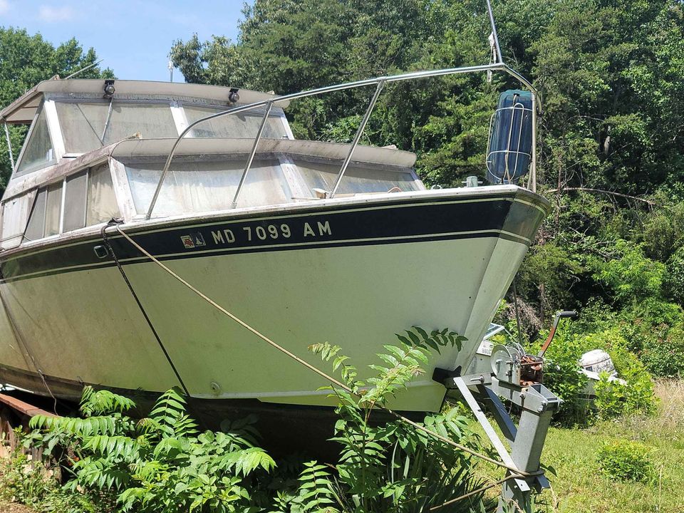

Hey all, I just bought a 1968 28' Marinette and although I've seen it several times (it's an hour and a half away and I need to put new rubber on the trailer) I never noticed until drooling over the pics tonight that there is nothing for the winch to connect to. I've been around boats all my life, but not this size and I'm wondering if this is normal? Should I run a line from my bow cleats to the winch to secure it?
There are no such things as stupid questions; just stupid people that ask questions...and I'm feeling dumb! LOL
I'll attach a pic...she's a dirty girl...for now- I'm going to make an honest woman out of her. :D

I have used 2 inch ratchet straps off of the mid cleats, it lets the boat pivot more as you come out of the water. Attach them wherever you can around the trailer tongue. It also works nice for keeping it straight while loading onto the trailer.
Rodney
Posts: 901
Re: Brand new Big M owner here...questions about trailering...
A line from the fwd cleats to the hitch, will help prevent backwards slide but probably not much help for side to side motion. A series of side straps to the cleats fwd, mid ship and aft will do that. Marinette never put a bow eye on its boats which was curious. Did they think that the smaller ones would not be trailered? Looks that way

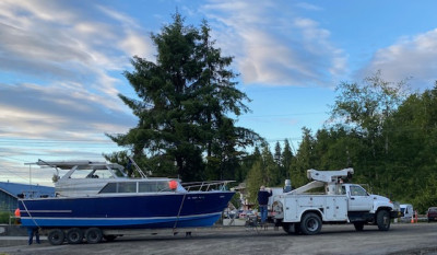

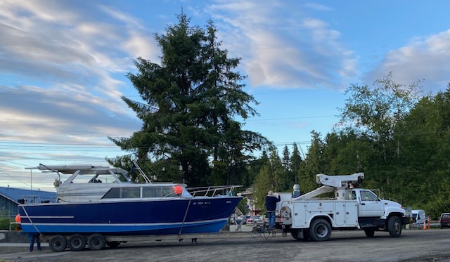

Here's how I strap it down.

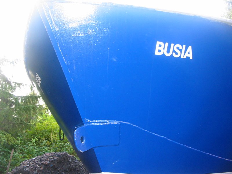

Here is the Bow eye I made. Welded it on.

Wow. That is beautiful. I am actually planning on painting mine a dark blue and now I know it will look awesome.
I am thinking finding a good aluminum welder near me is a must. Either that or learning to weld aluminum myself.
Thanks for posting!
