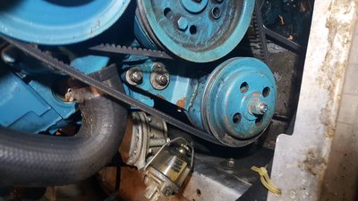

Sometime between 1977 and 1982 the second owners swapped out the original Chrysler for a Chevrolet here in Georgia. The issue that I am having is matching up the OMC / Chevrolet numbers, we have put a lot of hours on her and the initial drip from water impeller pump has turned into a spray.

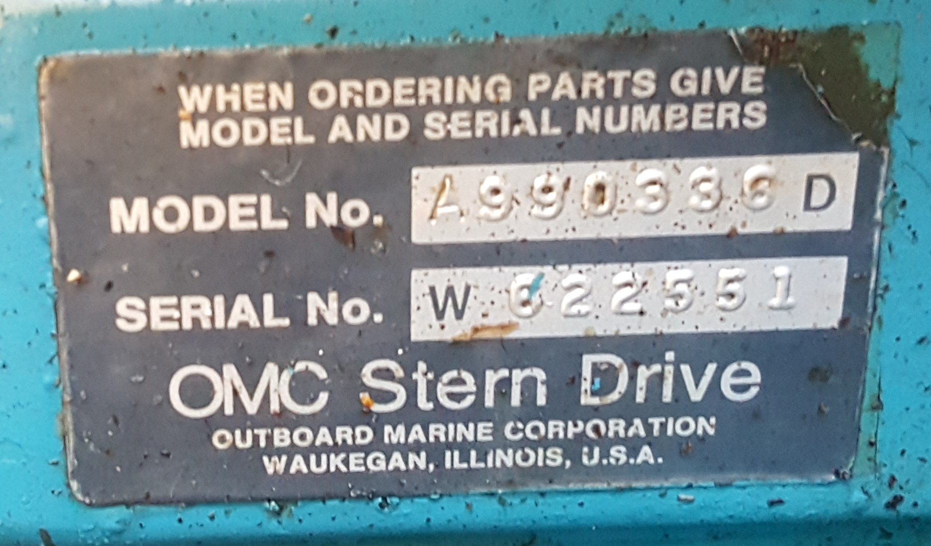

Can any of you all recommend, advise or send me a hyperlink for tracking down this vintage recipe, attached is the OMC data plate on our engine.
The impeller pump is unlike anything that I can find online and I am hoping to get back down to the coast soon.

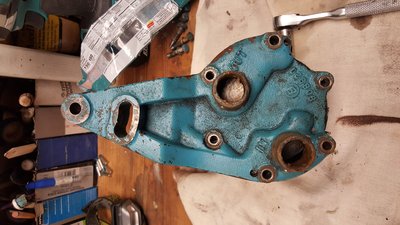

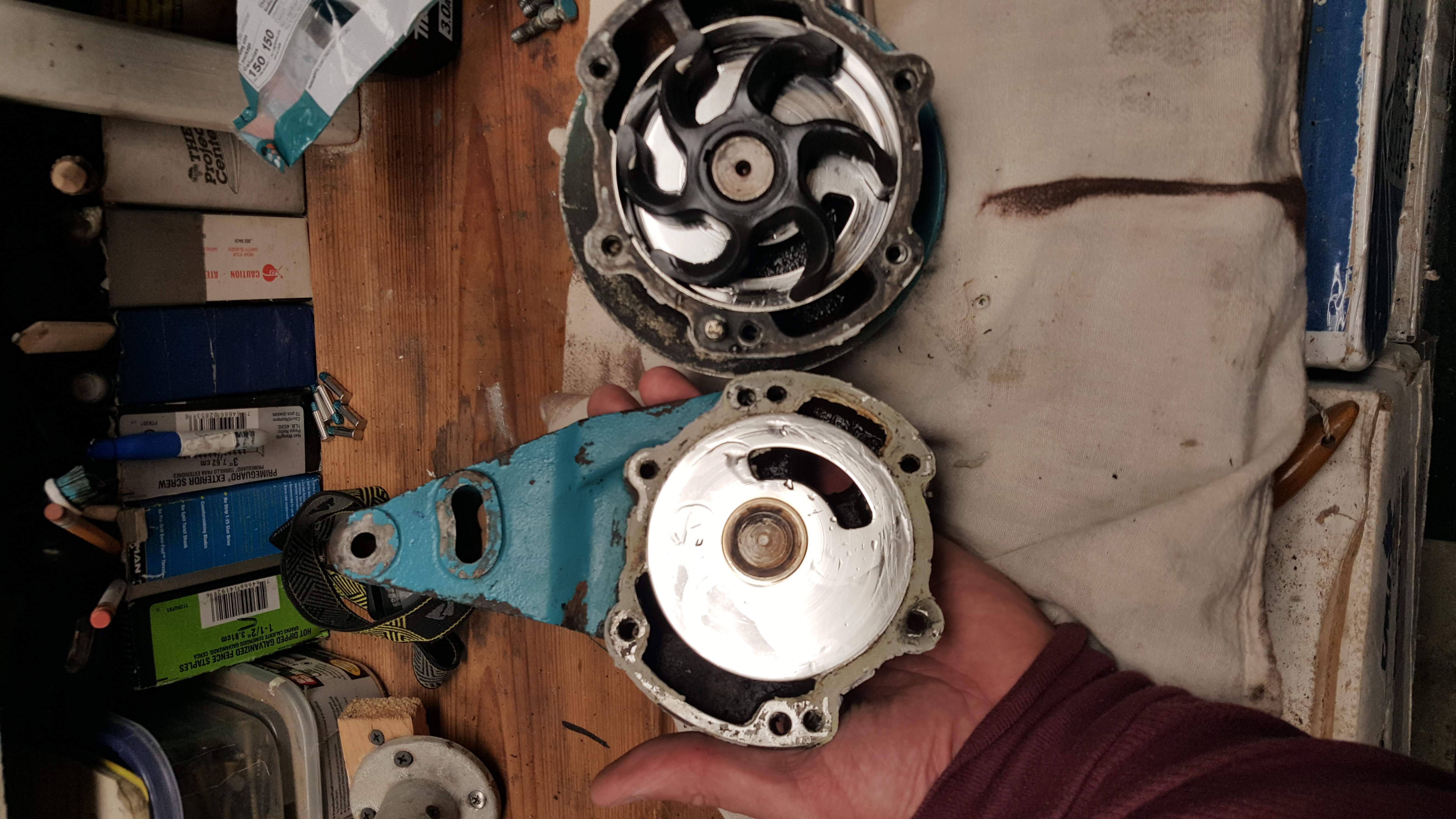

Thanks for checking Lois, I wish that it was that easy. Here are the pictures after I removed it:

Interesting I can not find a OMC model A 990336 D I can fine parts for the A version.
I would say contact a OMC shop that provides parts for old motors and have them research it for you

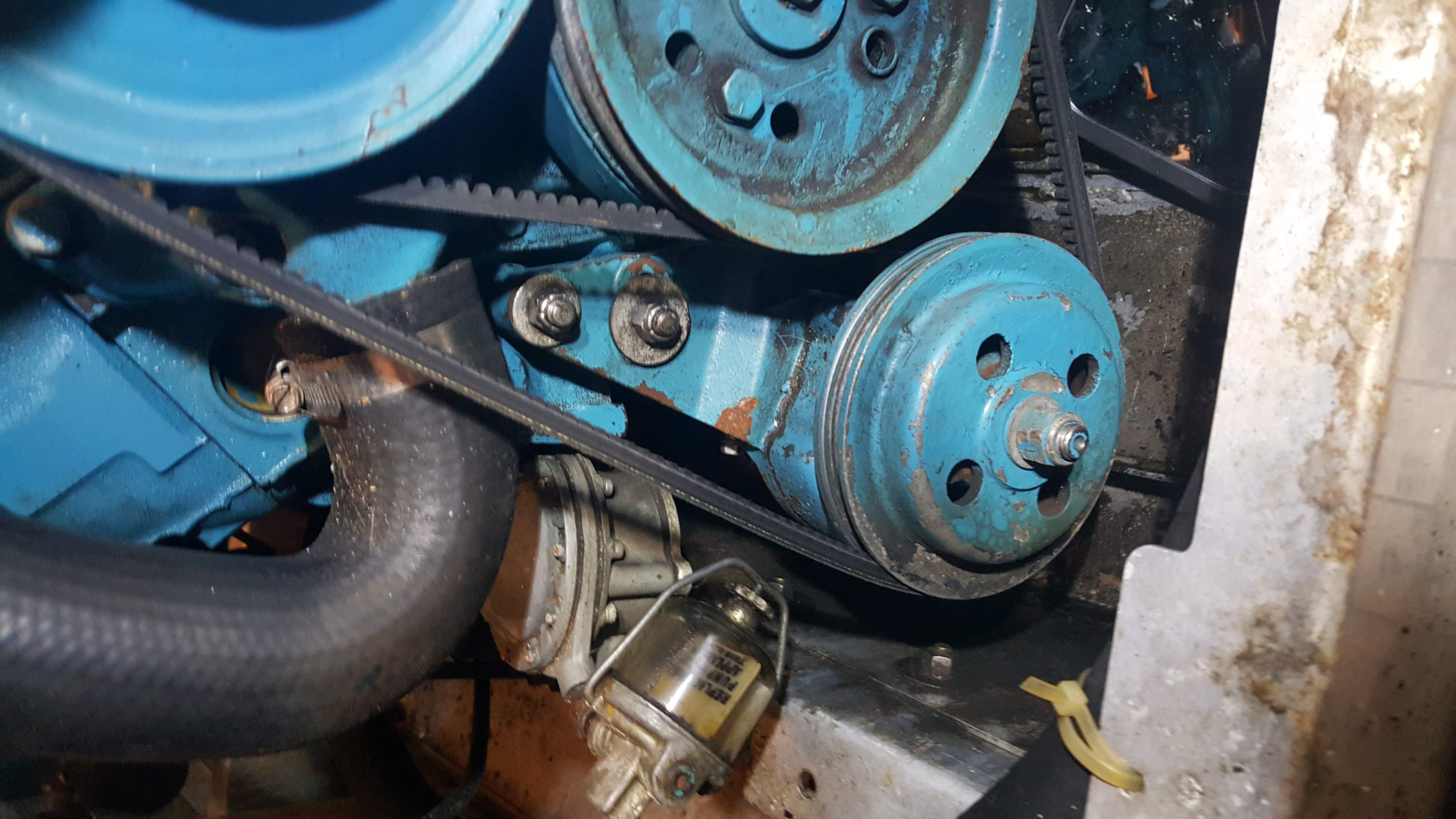

Also, that gas filter "gascolator" with the glass bowl is unsafe and illegal.
I would consider changing the whole pump and bracket to something you can find parts for.

I went with a Johnson pump f6b ( I believe ) crankshaft driven pump on my chevy's. If you have clearance in front of the engine, that would be an option.
