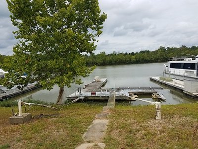

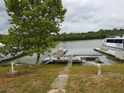

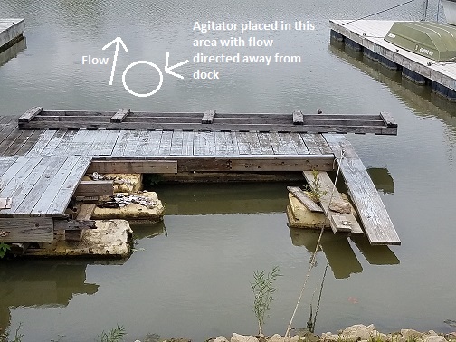

This year there have been a number of costs associated with moving to a new marina (current marina has very high angle ramps down to dock plus ownership has adopted some odd approaches to boating). The new marina has you owning the dock you use (situation where you're leaving a 50' wide swath of shoreline, electric & water access provided). We bought the existing dock which needs a fair amount of work (1 corner of the main section missing and I'm gonna rebuild it shortly...
Now the question:
I'm going to install a water agitator ( https://kascomarine.com/wp-content/uplo ... 2-8-18.pdf )
in the dock area to prevent icing (which, if it occured, could damage the dock and boat should the dock area freeze and the Ohio River rises (lifting dock and boat which, if it's locked in ice, could be bad! :cry: )).
So.... what I'd like folk's opinion on...
- With a water agitator in place at the head area of the dock and the boat backed into the slip, the water should remain ice free. Are there any inherent issues with this set up?
Eventually, we plan to buy a used section of dock as an opposing "finger". This would give us an 'anchoring point' at each end of the fingers to direct the deeper (and warmer?) water INTO the dock area which should do a better job of keeping the boat and dock areas ice free. As it stands right now, the placement of the agitator will have to run caddy-corner from 1/2 way up the left (existing) finger to the right corner of the existing left dock (as you look at the whole dock from the shore).

The placement of the Kasco unit (ordered last night with the optional timer/thermometer) is somewhat in question:
- Option 1: With only 1 finger in position, I can position the unit nearer the head of the dock (closer to the main dock area as noted in the pic).
Boat pulled into dock area bow first. Mooring lines for the Kasco unit secured at finger AND on corner of main dock.
Water depth there is 4'. In my mind, not the most effective positioning as this won't have the draw of deeper (7' at finger's end) and
warmer water to circulate under the boat (whose deadrise will help with disbursement of the water around the dock & finger itself.
- Option 2: Back the boat into the dock area. Position one mooring rope for the Kasco unit in front of the bow on the finger. Take an 8' 2x4, bolt
it thru the slots of the swim platform, angled slightly out and away from the aft end of the boat. 2x4 would have an "eye" bolt thru
the end over the water and the 2nd of the 2 mooring ropes secured to it BEFORE bolting to the swim platform. Then adjust the position
of the Kasco unit so it's slightly nearer the finger and angled to push water toward the main dock.
--> in my mind (that very cavernous area that just needs more projects to keep it busy! NOT!!!!! :lol: ) this setup would draw warmer
water from the deeper area (7' depth at end of finger) and push it towards the boat and dock. This setup would then allow the
boat & dock to rise and fall with any possible flooding.
The "CONS" - the potential (remote) of the rope secured to the 2x4 to freeze in place and a rise in water level causing a strain on the
swim platform. I can mitigate this by cutting a "strain relief kerf cut" across the 2x4 about 1" deep and spanning that kerf cut with
a 3 inch section of old anode. Anode would be screwed in place on one side of the kerf cut. The other side would have a oversize hole
drilled into it and a 16lb nail hammered in place that's been clipped off 3/4" above the anode.
* The idea would be that:
Should there be a strain on the 2x4 in a vertical manner (ice formation and boat/dock rising) the 2x4 would start to bend down at the eye
bolt. The anode span would act as a "safety". If the bend is too much, the kerf cut would allow the 2x4 to break, the anode 'safety' would
be cleared and there'd be no damage to the swim platform. This all would have to happen almost overnight as weather of such extreme
would be forecast and I'd be checking the boat/dock and operation of the Kasco unit more often.

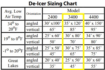

One annoying thing about deicer...
Kasco's site says their 3/4 hp unit should keep an area larger than the 30' x 50' targeted area I want to keep ice free.
"A single 3400D unit can keep a circle of water open up to 75 ft. in diameter."
Deicer chart.jpg (48.03 KiB) Viewed 37869 times
Guy at Kasco says, based on same pic as I posted above, I'd need 3 units?!?!. His explanation was that I'd need more that 1 unit because the dock is using floats. Seems that was a sales pitch when their site says otherwise?
