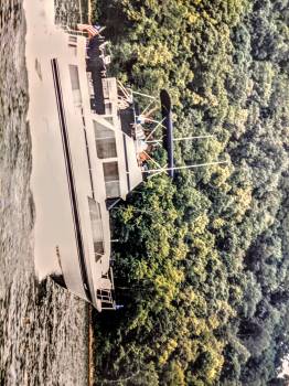

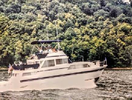

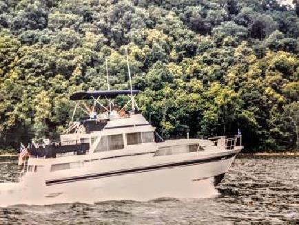

Here she is in 2003 o think this was witihn a couple of years of her last days on the water before she went to a storage yard.

Nice boat.

Thanks for the rotation. I have a lot to learn on the big M's. I absolutely love the design and the construction. It blows me away to look and see how well they are put togeather. I purchased a unknown project that at one time was a nice boat. Currently I have lots of investigating to do. It is somewhat overwhelming but I will manage. Getting these engines freed up is priority number 1.
