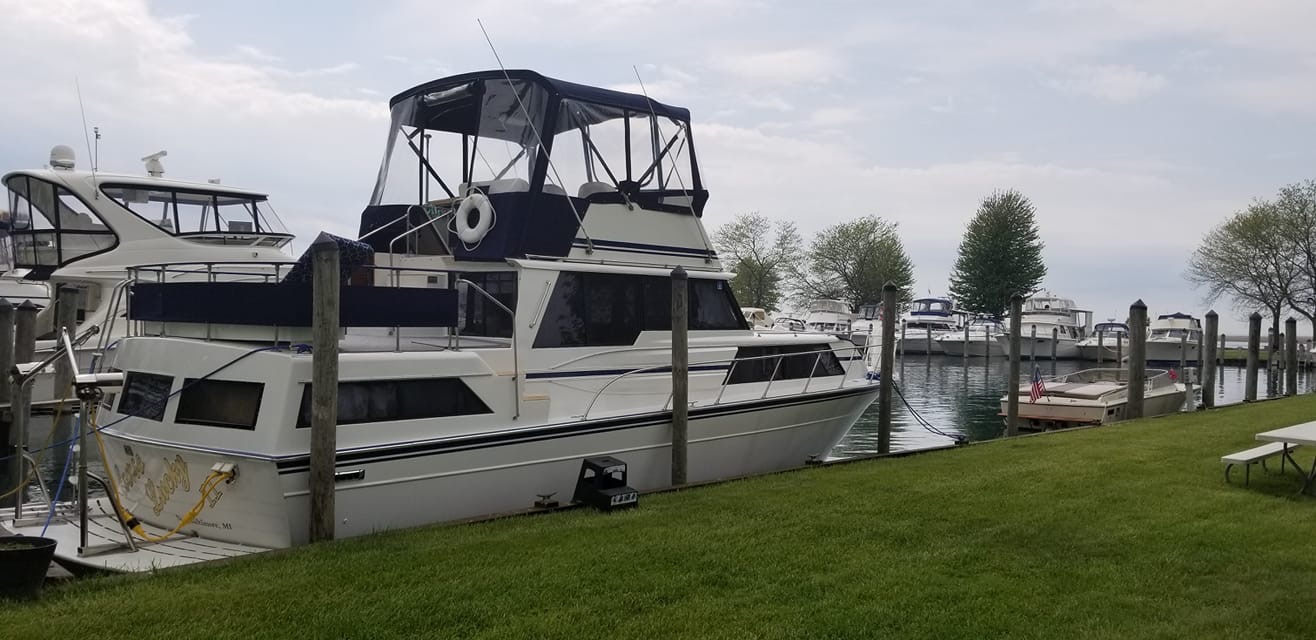

If you're still looking for an extended platform, I dit it on my 28' and cut a transom gate.
The company is outside Canton, OH. I also used their product for the cabin sole and the flybridge deck.
https://www.plasteak.com/plasteak-recyc ... -platforms
I had it installed by a welder using aluminum angle brackets at the same height as the original. I have no problems with it at any boat angle. I made a cardboard template of my desired size and delivered it to them. (I'm in Youngstown OH). I also bought one of their under mount extension stainless swim ladders. I can set a small folding chair on the platform. It has transformed how we use the boat.

Re: Extened Platform
Added a foot plus to my old 32 footer, then hung a 9 foot dink and its 60 hp motor from it without problems.
Another option that I forgot to mention. The platform from a 28 can be used to extend an existing one on a 32. My old one was sitting around at the marina and an owner of a 32 asked to buy it. The curve on the transom side of the 28 platform is an exact match to the back end of the 32 platform. Just a matter of adding some underside supports. I don't know if this applies to a 37.
Beautiful boat and that swim platform looks just like what I had hoped for. I will reach out to the company in the link and see what we can come up with. Now to design or find a set of curved steps for the aft so our dog can board the boat. Lol
