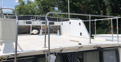

Before

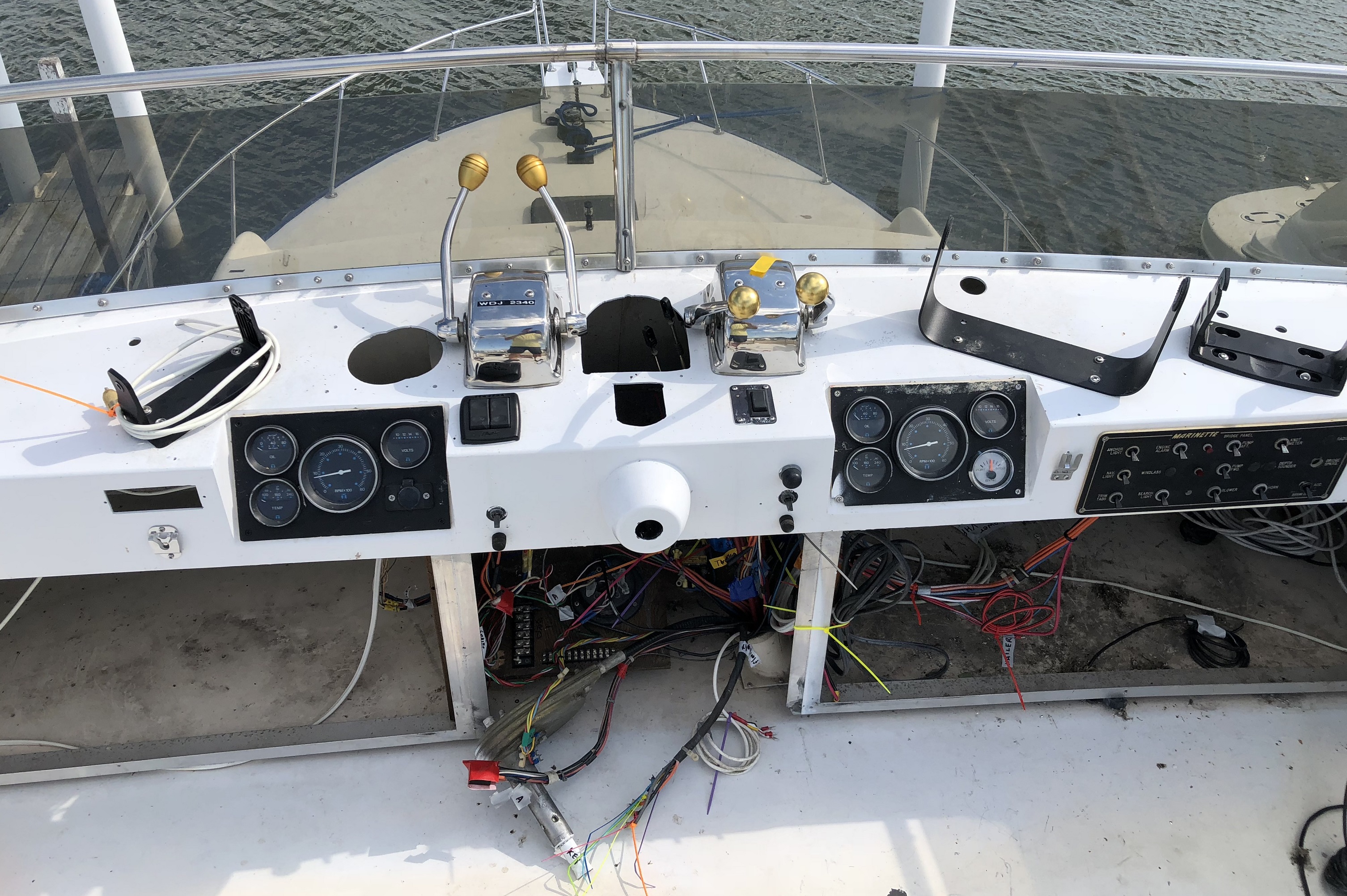

Ready to remove bridge:

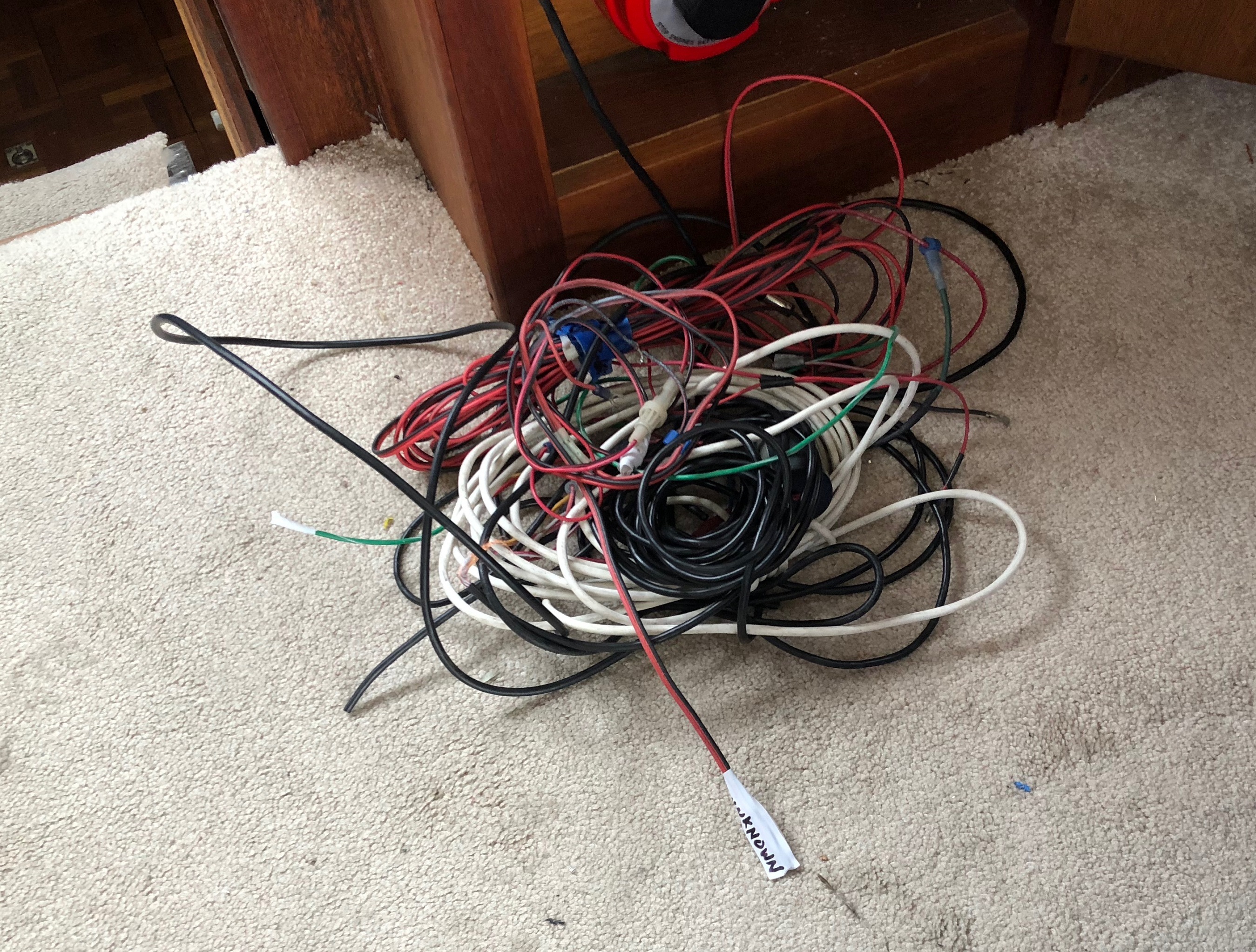

These are some of the unused and "not connected to anything" that I pulled from the boat when disconnecting things for flybridge removal. This is not all of it but most...

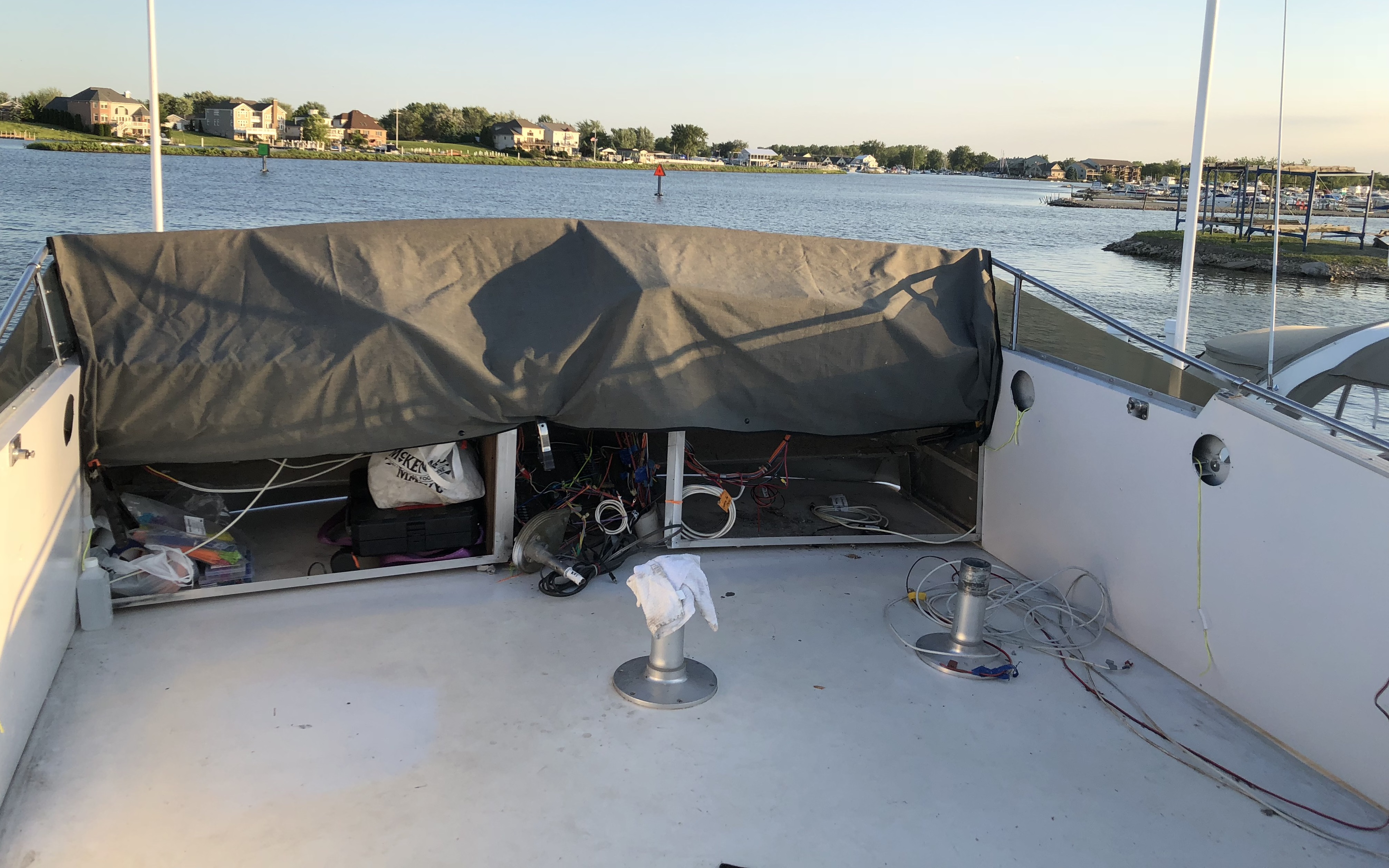

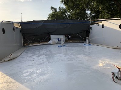

Stripped flybridge waiting to be moved to the bow tomorrow.

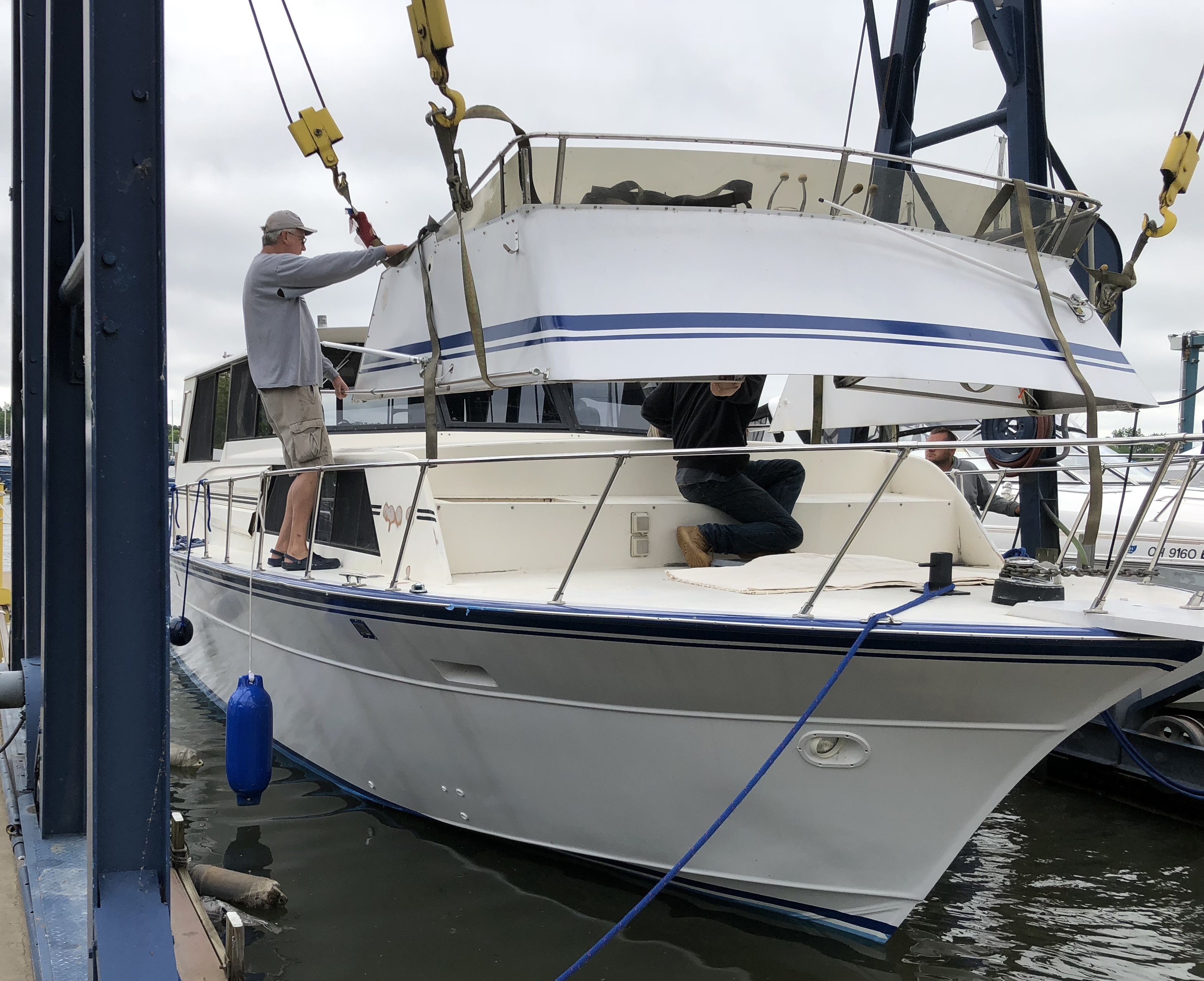

Final chapter...
lifting flybridge and everything was disconnected! I bet I would find something.
