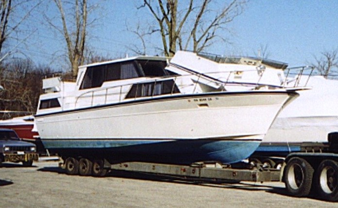

Bridge removal advice from postings here over the years: Mark/label every blessed wire -both sides, of course. Some have described tying it down tight on a carpeted foredeck.

The flybridge loaded toward the bow looks precarious...

Does anyone know the height measurement from the top of the main cabin (w/flybridge off) down to the prop tips (lowest point)?

On a trailer, like the one pictures above, mine is a little over 13'. a semi trailer is 13'6".

The leading edge of the top, of the Plex-glas windscreen, the highest point while on the trailer, mine is 15'1", that with the props roughly 12" off the pavement.

javalin390 wrote:The leading edge of the top, of the Plex-glas windscreen, the highest point while on the trailer, mine is 15'1", that with the props roughly 12" off the pavement.
So I wonder if I removed the props, how much lower could I get the boat on a hydraulic transport trailer? could I get down to around 14' without removing the flybridge...???
