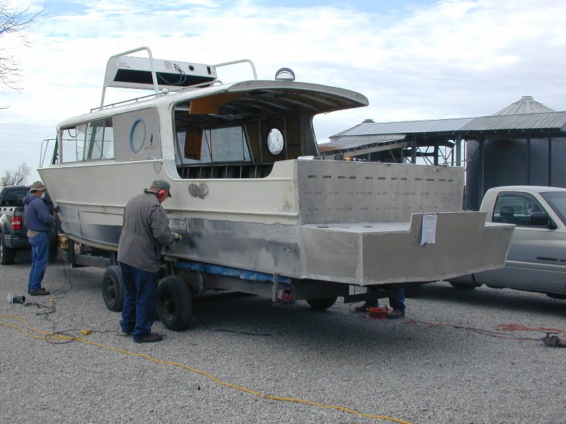

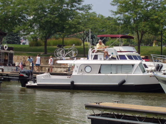

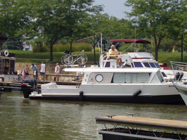

Not sure if it was a member of this post, but someone has done a older 60's M, and as I recall it was a rather extensive (and expensive) endeavor. Outcome was beautiful, but involved welding on an additional couple feet to the boat for the outboard transom. Some other members of this site should remember her.

The link shown is the design phase, and I've seen photo's of the finished boat, just can't find them.

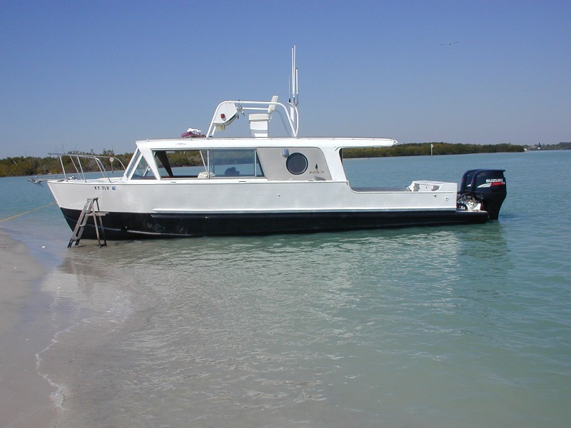

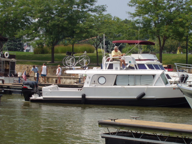

Here are some pictures. One of these is when he first put a single outboard on the boat. The rest are when he upgraded to twins.

Big BigM 's Rule !!!

Nice job on that old boat by the way.
