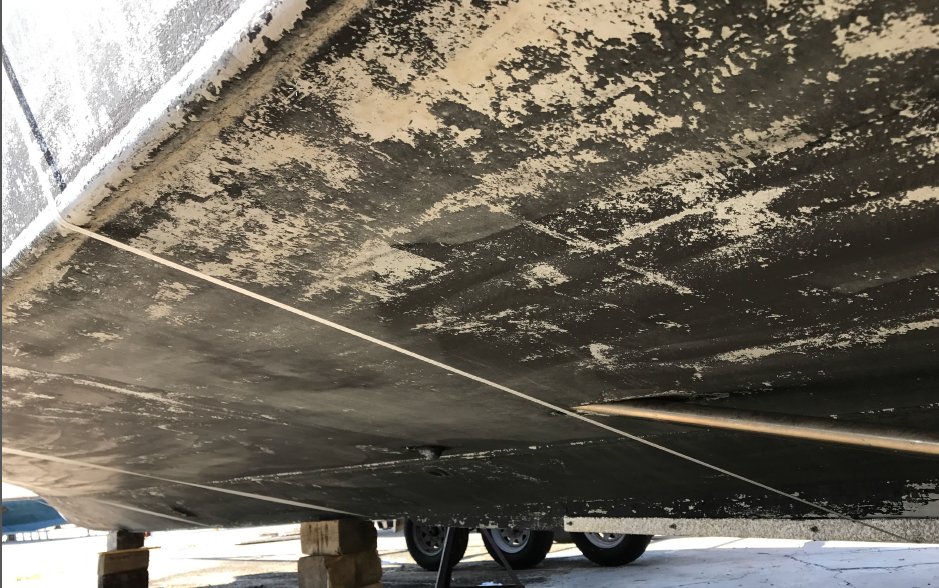

Hello,
Recently acquired a beautiful M-39 and need advice. From the attached photo, what is the recommended procedure and estimated cost for painting the bottom of this 39.
Thanks,
Kim
Posts: 537
Re: Bottom paint recommendation
Kim,
First, welcome the forum!!! :-)
Unsure if your pic's "light area" is actually bare aluminum or a previously painted surface. If bare aluminum, you're going to need to scrape the entire surface to remove any loose paint AND THEN sand all exposed aluminum. This may be more effort as compared to getting someone to (sand) blast the bottom down to bare aluminum***. Cost - I paid about 350.00 to have mine done several years ago. Shop around!
*** You MUST!!! apply at least 1 coat of a 2 part epoxy primer (Interlux's Interprotect 2000E is what I recommend) IMMEDIATELY. Newly exposed bare aluminum will quickly develop an oxidation layer to protect itself. That oxidation layer will cause failure of applied paint to adhere to the hull. One coat is all you need immediately. (See below if you have pitting in the hull). After that 1st coat <and pit filling, if needed> you'll want to apply 1 or 2 additional coats. I say this because, down the line, you'll want to apply another coat or 2 of bottom paint. There can be a time lapse between coat 1 and 2nd coat of the 2 part epoxy primer. With the surface having 2-3 coats of epoxy primer applied and in good condition, you won't have to worry about sand blasting again.
After the 1st primer coat - if the bottom has any pitting, now is the time to fill in those pits (Process recommended by forum "old hand" FastJeff). My recommendation is a product called PC-11 which is a 2 part waterproof epoxy (fairing material) that wears like iron. Mix only enough that you can readily/efficiently apply with a heavy duty plastic paint scraper. I'd shy away from metal scrapers. They could scour / gouge thru the 1st primer coat. Smooth the PC-11 as best you can. Once it's cured, it's a bear to sand down (but can and should be done). After pits filled apply the 1-2 added coats of 2 part epoxy primer.
--> I would recommend different colors for the epoxy primer- start with gray, 2nd - white, 3rd - gray. This way you'll be able to see any spots you missed AND when getting ready to reapply bottom paint, you'll be able to see just how badly the bottom paint has worn down (ie. you see white - 1st coat of bottom paint - you should apply 2 coats of bottom paint after prepping hull, all you see is black (or mostly black <or whatever color your final coat will be>) then the bottom paint's holding up pretty good. Maybe a touch up or maybe just 1 coat needed.
Bottom paint -
NOTE - some bottom paints require the initial application within a certain time frame after the last primer coat's application.
I just repainted the bottom of Sunset Seeker with Interlux's Micron CF. I painted 2 coats - 1st white, 2nd black. Doing so ensured the final coat was thoroughly applied. The white coat pretty much assured I covered the previously applied bottom paint.
IMPORTANT - under no circumstances should you use any paint containing copper!!! Doing so will cause deterioration (corrosion) of the hull. Yes, the Interprotect affords some protection, but do you really want to chance it. And Interlux's non copper paints are quite good. There are a number of other copper-free brands out there and I hope that other forum members will add their 2 cents pro and con.
Cost and coverage - somewhere on the web there are calculations for determining the surface area of a boat's bottom and the amount of paint needed. Here's one: https://www.google.com/search?q=how+to+ ... e&ie=UTF-8
If you're a very good painter, you can rely on these calculations. If you're like me, you might want to add an additional quart of bottom paint per coat. It's lousy to be painting and realize you're going to come up short. Then it's setting things aside, running somewhere to pick up a (expensively priced!) quart. I have found the best pricing for what I use to be Wholesale Marine. But I urge you to do some research before buying. You never know when you might run across a deal.
