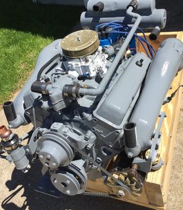

I am replacing with a couple rebuilt crusaders I picked up. They are actually chevy 307's .030 over. I have rebuilt my share of motors over the years, so did it myself. I also prefer closed cooling as you can run the engines closer to the temp I think they run best (warmer), and it is easier to winterize. Will see how it goes. Chryslers are on ebay - no idea on hours. I have had the boat for 2 years.
