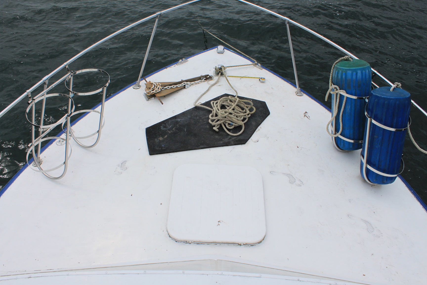

Yeah. I have a power windlass available already. Not getting the idea how to place the roller for the rode. Straight in line from the bow is nav light, king post and then hatch. I was imagining adding a pulpit, but considering it may be more practical to bring the anchor up on deck off to one side a bit.
The only problem with a 35 pound anchor is having to bring it up! I am doing a lot of anchoring out in the Thousand Islands this season so it has me wanting some help.

I took your suggestion Joel and have found someone at Lewmar that is willing to give me some ideas. I sent him a picture of the bow layout and right off he asked me if the anchor chain can drop into the bow hatch. I told him that the Redhead is in there and that might not work out. His suggestion was I could get rid of the Redhead. Well, my anchor is not that heavy I guess.

A lot of boats here (and mine) use a plastic container on the foredeck to hold the anchor chain because it won't go down into the chain locker. (I have a milk crate, seems to be sturdy and work well. Just not very nautical) I can see that a pulpit would be nice, but not worth all the money and trouble it would entail. So maybe a winch to help pull, or a smaller anchor, or another redhead to help.

I use a plastic ammo box attached to the entrance to the chain/rode locker. I only use 15' of chain attached to my rode which seems to be sufficient to keep the anchor on the bottom and set well. Cutting a hole on each long side of the box allows for entry/exit of the chain and keeps it looking pretty neat. For those who wouldn't want water getting in (rain/spray), you could hot glue a "gasket" of 1/2" foam window sealer around the edges and a larger piece of foam pipe insulation at the holes.
Re: Retrofitting bow anchor platform
The ammo box seems like a good idea. For the water in the box, I would just drill a drainage hole down low.

Can't use a lighter anchor. A lighter anchor found me in the morning on the wrong side of a bay a few feet off a shoal.
I guess to have the rode fall into a box or crate on deck I'd have to put the winch/windlass on a pedestal. Not impossible.
