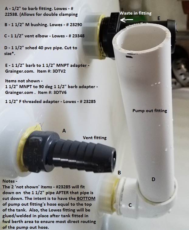

In the process of installing a 19 gallon holding tank under the front berth. Using a Moeller tank.
The pump out fitting is a 90 deg 1 1/2" elbow with barb fitting. New hoses (non permeable) will run from the tank's pump out fitting to the deck fitting. Additionally, that same type hose will run from the vent outlet to the vent fitting on the hull. All fittings, as they are attached to the tank, are secured using plumber's putty which ensures a water tight / corrosion resistant connection. ( I know as I've filled the tank 4 times with water to check for ANY leaks!).

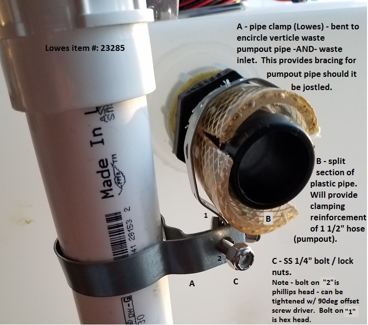

To ensure the tank pump out fitting at the base of the tank remains rigid, I set up a bracing system:

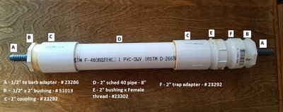

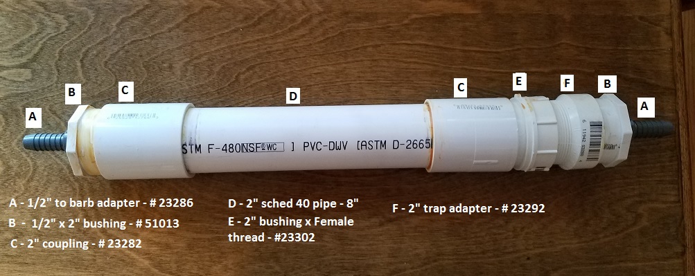

The vent line needs to run slightly uphill to allow for fumes to escape. As it's not advisable (or desireable! :? ) to have holding tank fumes wafting in the air while you're anchored, a filter, using activated charcoal, is placed inline. Not wanting to spend a bunch of $$$ on a pre-made filter, I constructed one of my own.

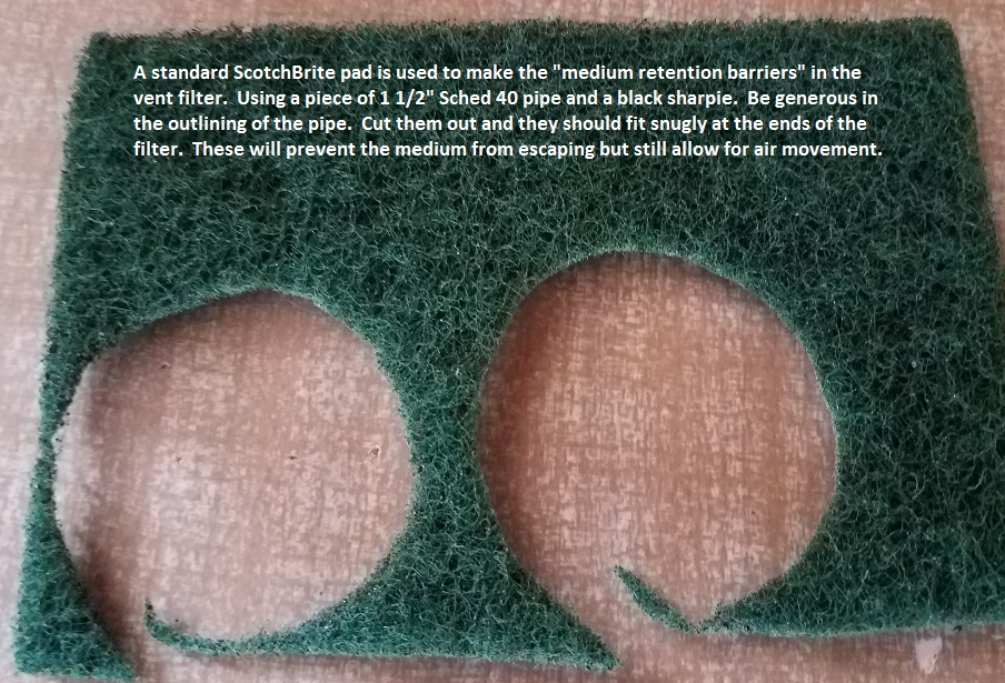

The filter's media is held in place using cut out sections of scotch pad scrubbing pads:

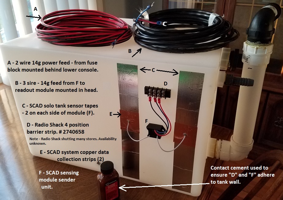

The tank's content level, being below the forward berth, will not be easily determined. So a SCAD tank monitoring system will be used to ensure the levels within the tank are readily available.
As mentioned, the vent line, as well as the filter, need to run slightly uphill. The filter will be secured to the berth/head common wall using 1 1/2" plastic "J" hooks from Lowes.
The readout panel will be mounted in the head. I debated on whether to mount on the lower steering station but opted instead to mount "where it's most likely to be noticed!" aka - the head. It'll be mounted under the basin which should put it within easy eyesight of a user. :roll:
The tank will be secured under the berth using aluminum angle sections at the base of the tank, with closed cell rubber cushioning between the side of the angle and the tank to prevent chaffing of the tank's sides. On my boat there's a 3/4" section of plywood in the forward berth just inside the louvered access hatch. That baseboard is hinged at the bow end. I'll install 4 SS T nuts fore and aft and secure the angle for those locations. I'm installing 4 SS T nuts (2 on each side) under that hinged baseboard at the sides. I'll then thread/screw in a 5/16" SS rod with SS flat & lock washers and SS nut to lock down angle retainer. At the top of the rods, a hardwood (with the same closed cell rubber cushioning underneath it <ie. rubber will be against the tank's top> batten will run across the top and connect to the other side's rod and secured with SS hardware. The same rubber cushioning will be placed between the vertical rods and the tank's side walls. In effect, no hard surface will be be in contact with the tank's sides or top. Once secured, it will be unmovable in any sea.
Some explanations...
I didn't put a barbed 1 1/2" fitting at the bottom of the tank with the pump out hose connected because I found the fittings on these tanks to be worrisome in that I feel that they aren't as stout as I'd like them. Given what the contents of the tank will be, I opted for 1 1/2" schedule 40 plastic pipe which is rated (and available at any home improvement store) for sewage. With the plumber's putty ensuring a good watertight connection, I also don't have to worry about standing effluent permeating a hose.
