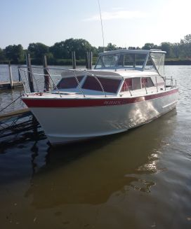

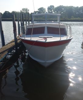

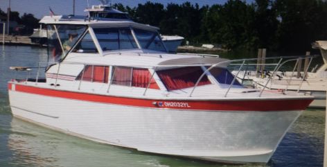

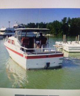

Work in progress.
1- new heads for 327 fireball Graymarine , rebuild or new.
2- trim tabs, make and size
3- paint , top and bottom , she is racked stored
4- windless
5- covers , bimini

PS- that is a gorgeous boat and I know everyone here appreciates you sharing! Let us know she comin!

Great looking Marinette.
