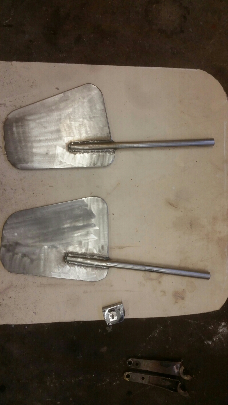

I ran into a unique problem on my steering linkage (other than the rudders) that frustrated me for a while. Because my boat has cable steering, the cable where it connected to the stbd rudder ran fore and aft. This meant that this rudder had a bell crank on it, or L shaped tiller, that had broken between the two arms due to the seized rudder stocks. It had a very cobbled repair done years ago that I was not putting back in. I could not find a replacement anywhere. Luckily the break was clean. I blasted it, machined the top of both arms for a brace, and had it TIG welded. Worked perfectly.
I was able to make rudders using my old prop shafts and some .250" SS plate. Turned out awesome. In the bottom right corner of the picture you can see the broken bell crank before repair.

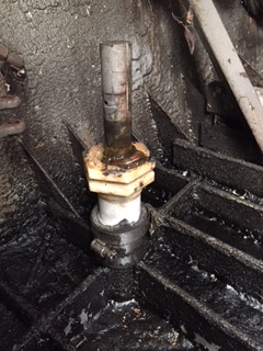

[img]
[/img]Sorry guys - sure this is covered somewhere on the site, but what are you replacing these with?
