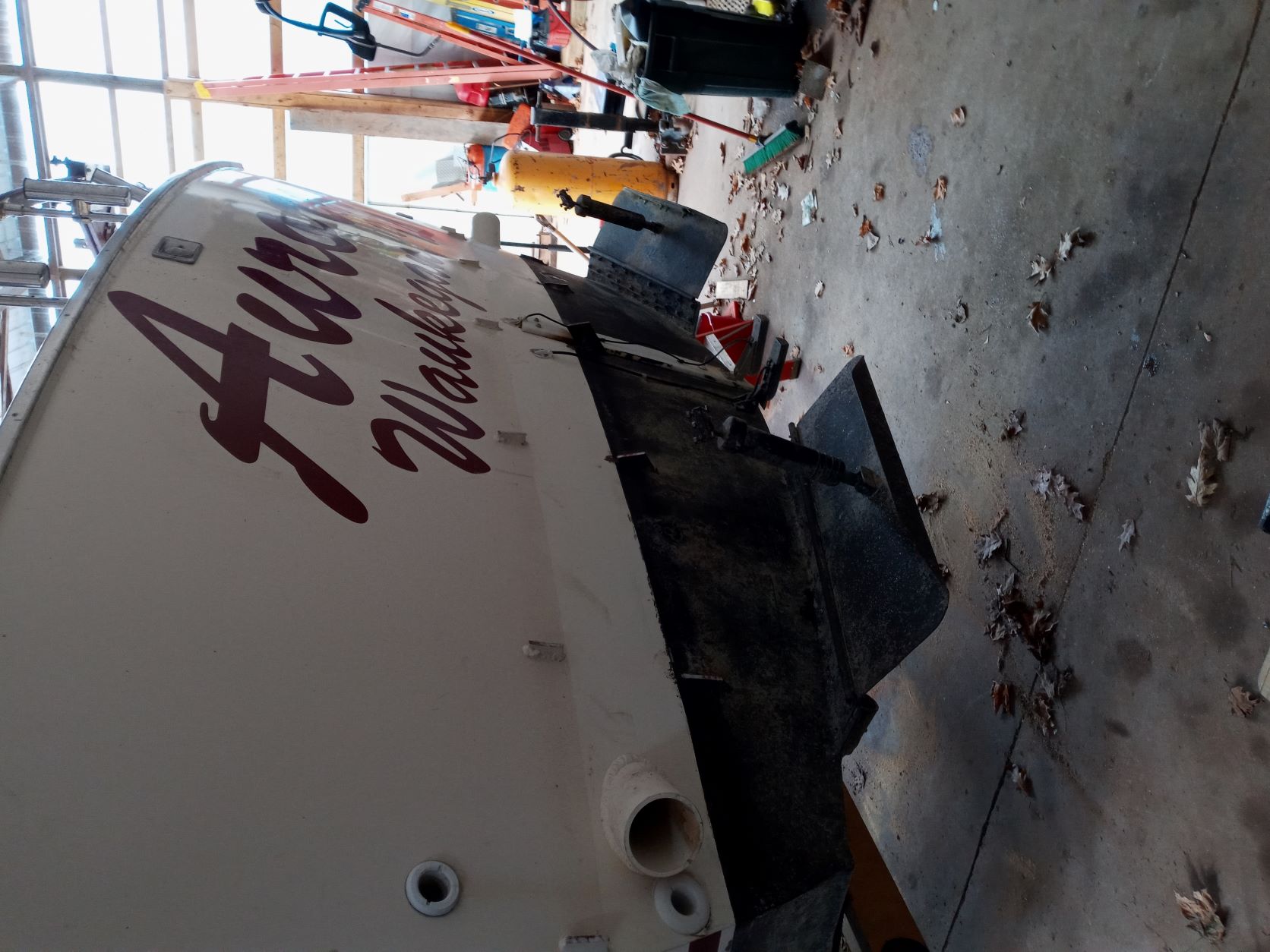

Original transom

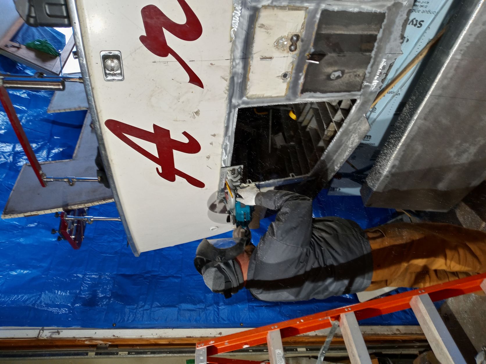

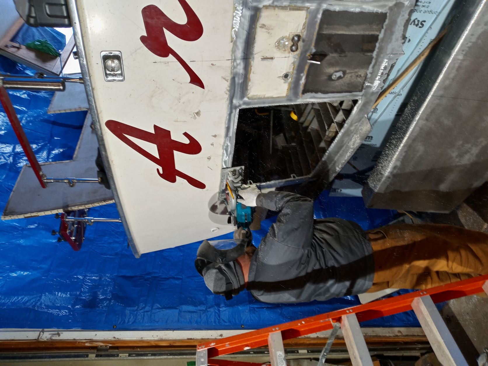

Post by TinLizzy »
First hole cut out.

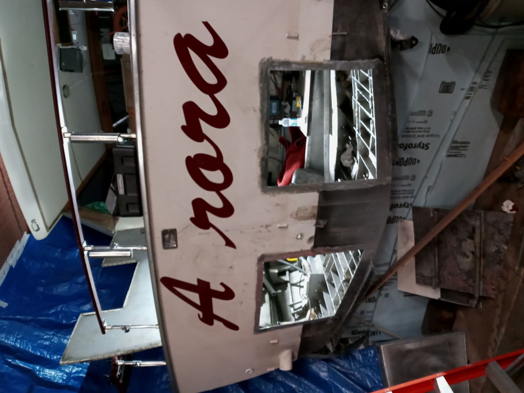

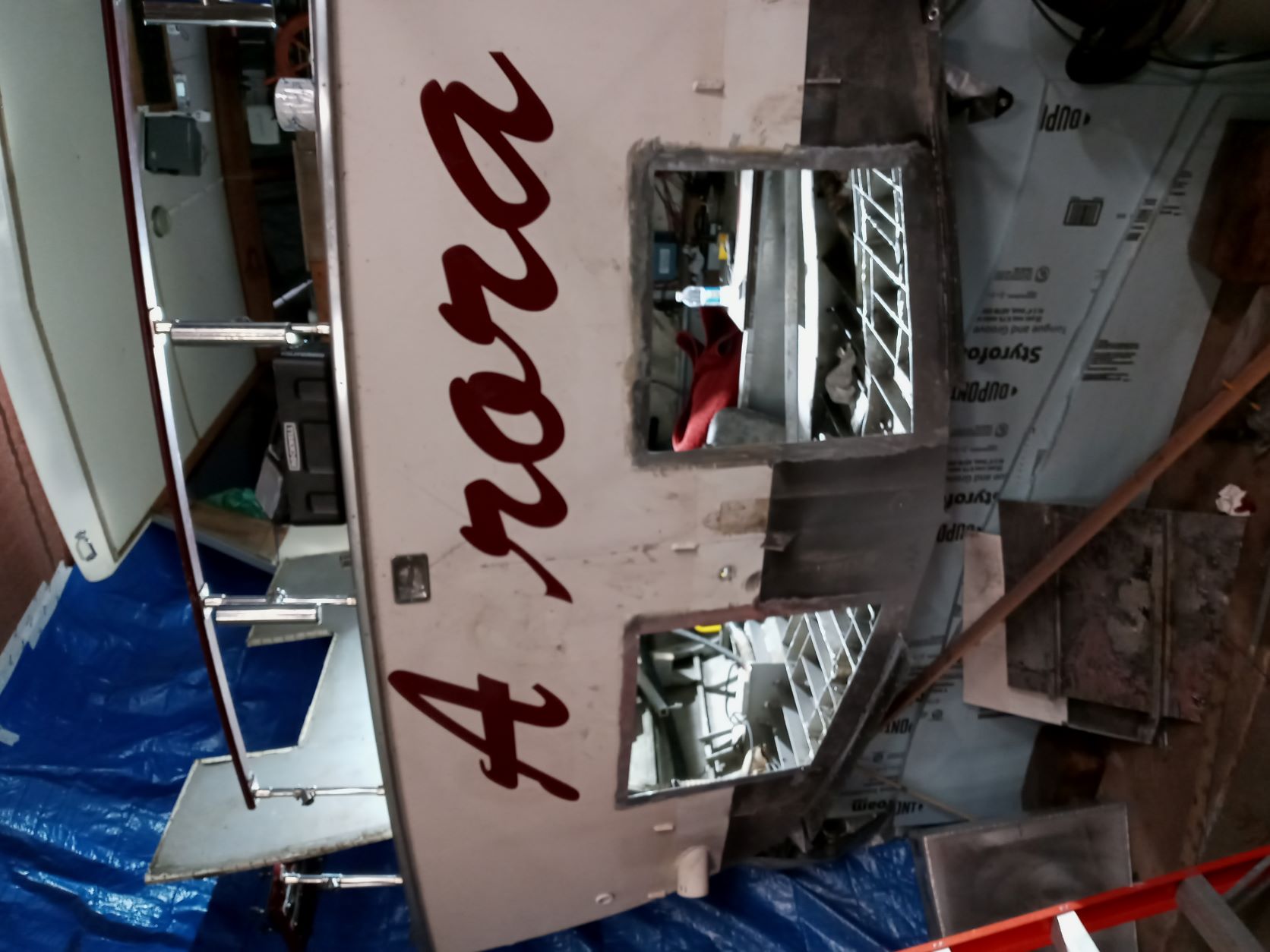

Post by TinLizzy »
Rodney
Re: A little crazy?
You're really doing it! Lots of people talk a big project but...
Like I said, if I lived near you I'd be there to help out.
PS: I just occurred to me that you might be able to mount the engines where the 360s are and use long driveshafts. I seem to recall that being done on race boats (with 3 and four engines). That would vastly improve your excessive aft weight difficulty.

I'm a lot farther along then the pics indicate. I will post a few here and there as I have time. It takes awhile for me to resize them to fit the post. Jeff, the jackshaft idea was discussed, but proved to be too involved and expensive to make it wort while for me. Many thousands of dollars to get the new bellhousings and mounts, exact length driveshaft, pillow block bearings, exhaust extensions with shutters, etc.

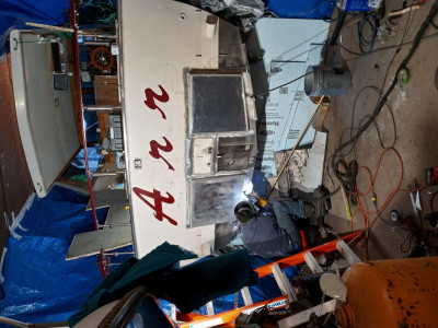

Post by TinLizzy »
Welding in the first boxes.

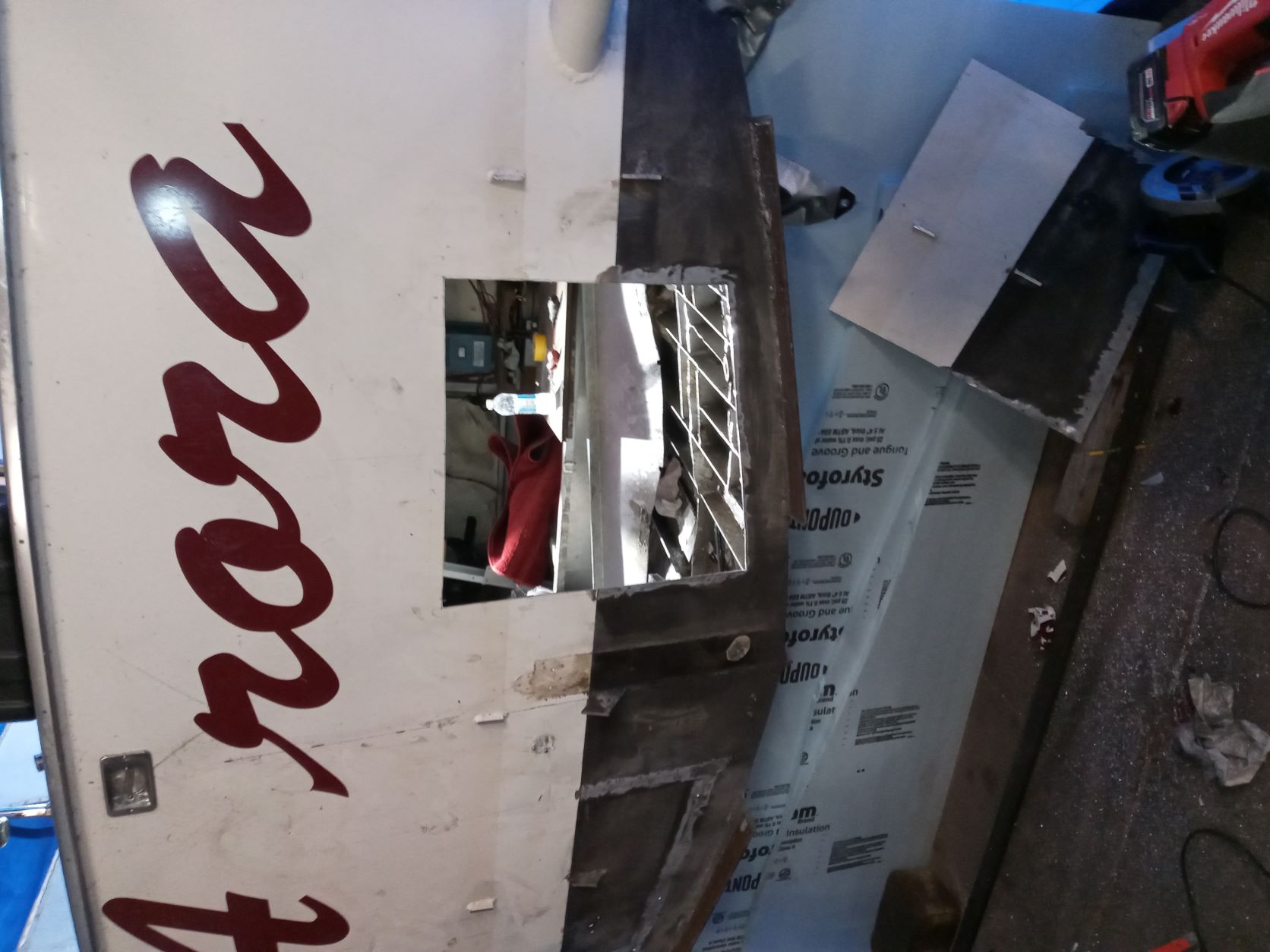

My measurements were off when the boxes were welded in, resulting in two non parallel planes. So, cut it all out, and rethink the design.
