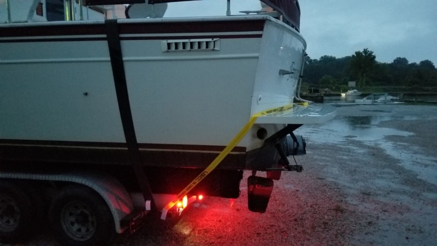

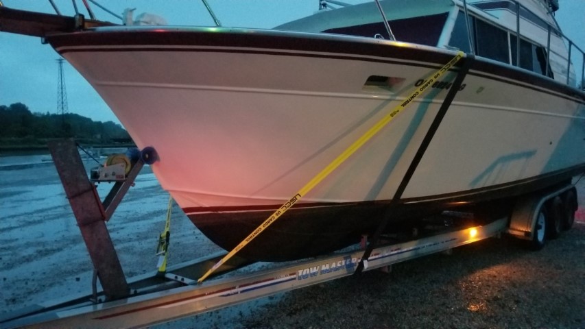

I just towed my new-to-me 85 32-Fisherman 400 miles from Ashtabula, Ohio to the Chesapeake Bay. I used two 4" straps forward and aft to hold her down secure to the trailer, and two 2" straps to prevent any movement aft, one from the forward cleats angled forward to the trailer and one above the swim platform to the trailer. She didn't budge!

Beautiful boat! Thanks for posting; I think even though I'll put a bow eye on for convenience, I'll strap like this as well.
