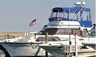

Here is the only crappy picture that shows most of the outside of the boat.
About how much does the flybridge weigh? I also have a 100 lb radar arch on it that I hope not to remove but may have to.
How many folks and what methods can slide the flybridge back into place on top?
Thank you in advance for your help...

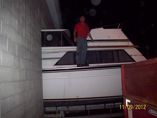

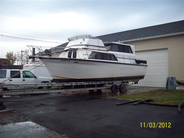

Hello. This is what I did on my 32. First on the lower front deck run 2 2x4s front to rear ,on the lower deck hand rail. Use some pipe strap and wrap around the hand rails. Then cut a 2x4 across the front , and cut 2 legs for the front. to make a frame. Then on the flybridge remove the screws. lift up one side and slide a 2x4 front to rear and screw the bridge to the 2x4. do the same for the other side. This will give you a "handle" to lift the bridge off. You have to lift the bridge up high enough to get over the "Tube " the wires and shift cables and steering run through. Then sit the bridge on the lower frame you built, and screw it to it. The radar arch will have to come down . If I can find a pic I will post it. Joe

Not the best pics. I painted mine in 2012/13 All my pics are on a computer with a hard drive problem. This is when I first pulled it out to get started. I was about 14'6" tall. Had to dodge the traffic lights.
Re: 39 Sedan purchase & transport
You really need 5 men. One in each corner and one to feed the cables and wires. On the ground 2 men can handle the bridge , butt its all you want.
