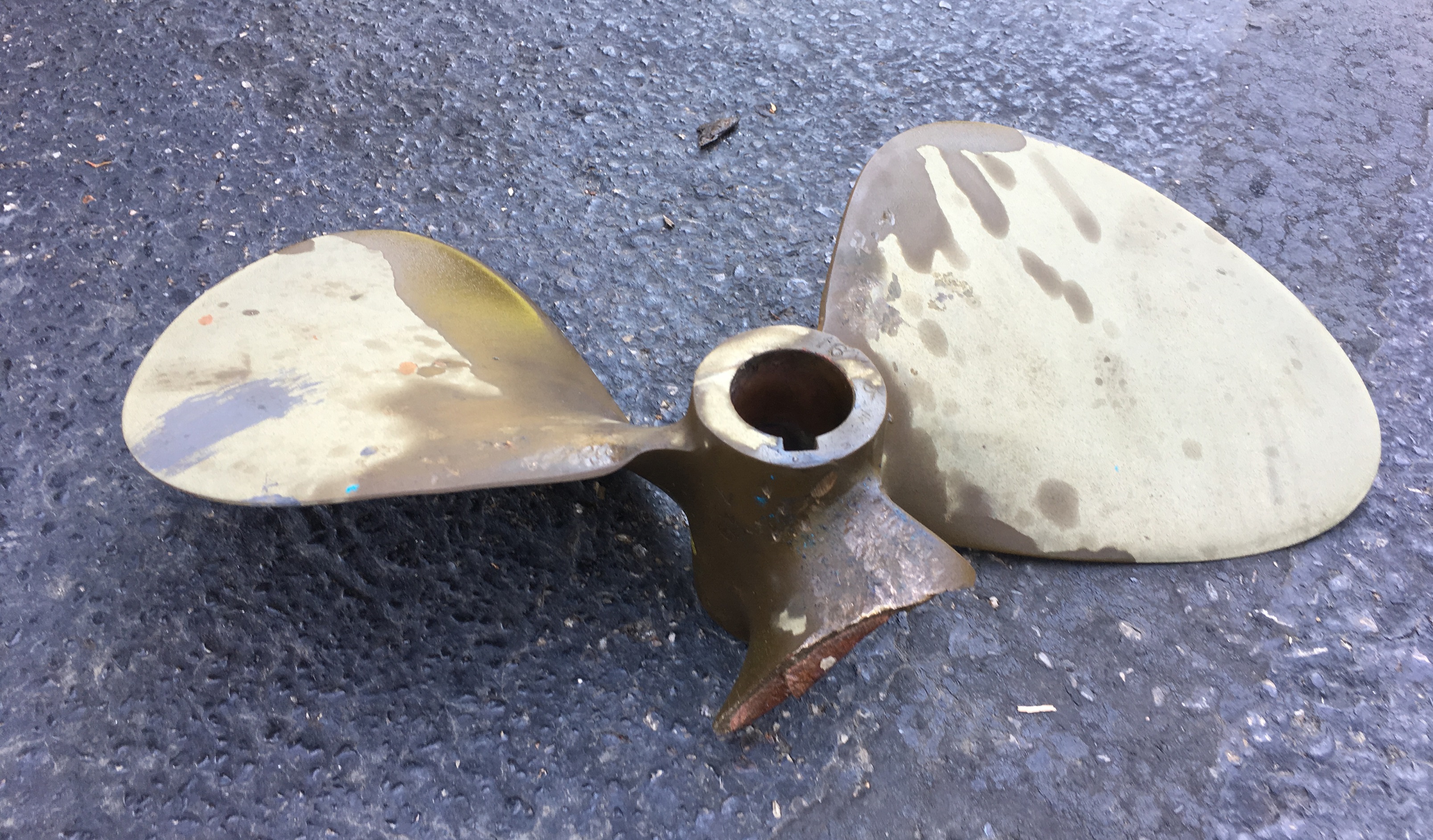

I am planning to stick with the 16x14 that is on the boat. My spare prop is installed.
I hoped have the damaged prop repair to become my spare but I don't think that it is repairable.
This is a picture of it. Does anyone have experience with a blade on a prop being almost completely rebuilt?
Probably going to be looking for a used prop...

Postby Busia » Tue Aug 22, 2017 7:27 pm
Hang that one on the wall.
