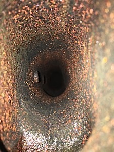

I pulled the elbow from the manifold (the 4 month side) and noticed rust specks all inside the hot exhaust side. I did use the silicone and see where it may have contributed. I scraped the old gasket and silicone off and sanded it down to the metal. I used new gaskets and installed the riser.
Do you think this was caused by a gasket failure or the fact that the exhaust has been full of water all the way up to the elbow while sitting for so long?

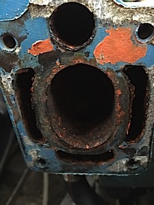

Re: Exhaust manifolds
This subject is near and dear to my anger bone! I had water issues for years on mine until I learned to silicone both sides of the gaskets when installing the risers.
The problem is a combination of gasket surface warpage over time (and heat), plus improper tightening of those 4 bolts. The weight of the riser hanging on the manifolds tends to make the top bolts do "less work" (so to speak) than the lower ones. So, when installing, I've learned to snug the top ones first, then the bottoms, then tighten the top ones, then the bottoms. (This is opposed to the usually correct method of cross tightening.)
Finally, I know OSCO and Barr literature says to not use a sealant, but they are talking about NEW parts that aren't warped. On other marine websites, this subject has been heavily debated with the Siicone appliers winning handily.
PS: In the above photo, note how narrow are the gasket surfaces keeping the water out of the exhaust--and see how many places it can get in there (especially at the bottom).

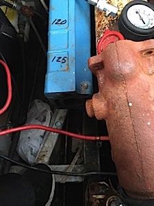

After installing risers (they just had manifolds & elbows) the manifolds run way hotter (175 degrees on each side) the risers are around 185. I'm a bit alarmed because the hoses were so hot, I'm worried about them failing. I did expect the riser setup to run hotter because the whole flow will be slower at idle because of the added area it needs to fill. The elbows are really cool though - 115.
Am I just new to this riser thing or should I be concerned? I'm postponing my test run until tomorrow so I don't break anything.
