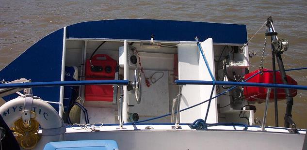

Re: Dingy Talk
Being me, I went bananas with what began as a simple dingy, ending up with a 9 foot speedboat with a 70 hp Merc on the back. So be careful!

Re: Dingy Talk
Jeff was kind enough to post pics on the old site of the dinghy build. Was great. And he posted post-completion pics of the dinghy in action. It screamed thru the water... !
... he stopped short of mounting wings on it...
... the FAA would've made him get a pilot's license!
Re: Dingy Talk
Actually, it was kinda slow--only 45 mph. But she handled rough water amazingly well.
With my Marinette now gone, I'll (hopefully) be building a new, no compromise, tunnel hull this winter.
Stay tuned!
