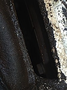

I can't seem to find the timing marks..
I read it was in the bell housing but I see nothing. Checking timing is a pretty routine thing right? (not that I ever have done or thought about it before)

The flywheel will be marked on the chamfered edge, right near your damper plate visible in your picture. It will be marked top dead, and I think around 15 degrees each direction (so that the same flywheel will work with either rotation). It is small and hard to see. You will most likely have to rotate your engine by hand and wipe the edge of the flywheel with brake cleaner on a rag to find it.
Unfortunately, it looks like the pointer on the bellhousing is broken or somebody removed it. See if you can find the timing marks on the flywheel first.
Which direction does this engine turn?

ug - its a ccw engine
So how would I find the center if there is no tab? Do I go medieval and feel out the piston stroke with a screwdriver? :lol:

You need to use a TDC finder. Take a junk spark plug, gut it, and thread it, then stick a bolt inside with a lock nut--that's your stop.
Next, pull the rest of the plugs--MUCH easier that way--and slowly turn the motor over until the stop hits piston # 1. (You have to experiment with the amount the bolt protrudes and hits the piston--about an inch).
When you're at this point, mark the flywheel (and/ or timing pulley) and rotate the engine the other way until the piston hits the stop again. Mark it here as well. TDC will be between these two marks.
Note" You want the two mark about an inch or two apart for accuracy. Adjust the stop as needed.
