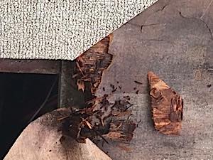

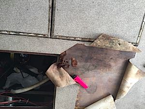

It almost looks welded. May modify that side wall because a) its mushy and the vinyl is just holding a sponge b) it looks deep enough to hold my fenders & c) I need to figure something out with ventilation below deck because the salt crust and condensation down there is CRAZY - IDK - I'll keep you posted.

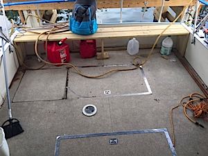

Pics so far - Shout out to the guys at Shell Lumber in South Miami (http://shelllumber.com/) - Its very hard to get good service here in Latin America but these guys were awesome. Cut my deck puzzle for $25. Much straighter and faster than I would have been.
