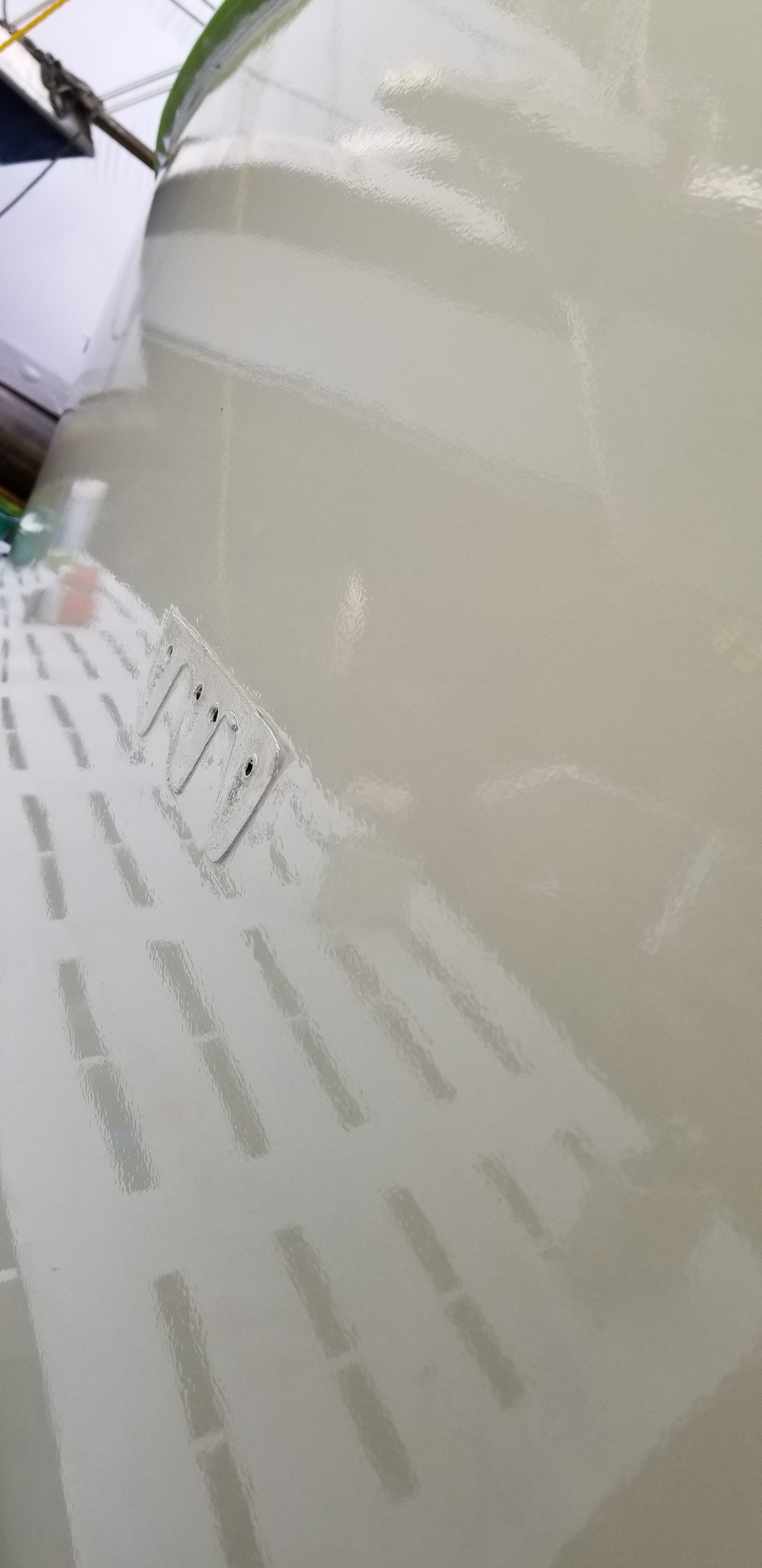

I am removing the PO boat name that was painted on the transom. Once the painted name is removed, the white paint that was under the name is shades different from the surrounding paint on the hull transom. So, I intend to repaint the transom before placing the new boat name on. Question is, what brand of paint and color do my fellow Marinette's recommend? The PO left a box of paint cans with the paper label gone but with "7923 Marinette white" written on the lid. Searching the net for cross-reference to the "7923 Marinette white" was a dead end. My take from our forum, the preferred paint brands are imron for spraying (no way), Interlux, Awlgrip, and Rustoleum.
Thanks,
Kim
Painting of hull transom topside question
