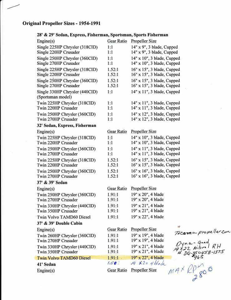

Found this on the FB forum a while back...

Hmm so I may be under propped. I'll have to check that when I get back home.

Our props are 19x19. The boat runs well with them, especially if you have several extra guests along for the ride. The props were 19x21 when we bought her. We dropped pitch after we added an enclosure to the fly bridge and filled the boat with gear.
I would run the boat to see where your WOT RPM's are at. If they stay within Chryslers recommended spec then I would leave them be.
If you are unsure of the condition of your props, it might consider pulling your props and have a prop shop do a prop scan on them. When ours were checked the shop found different pitch on blades as well as some blades slightly shorter than others.
