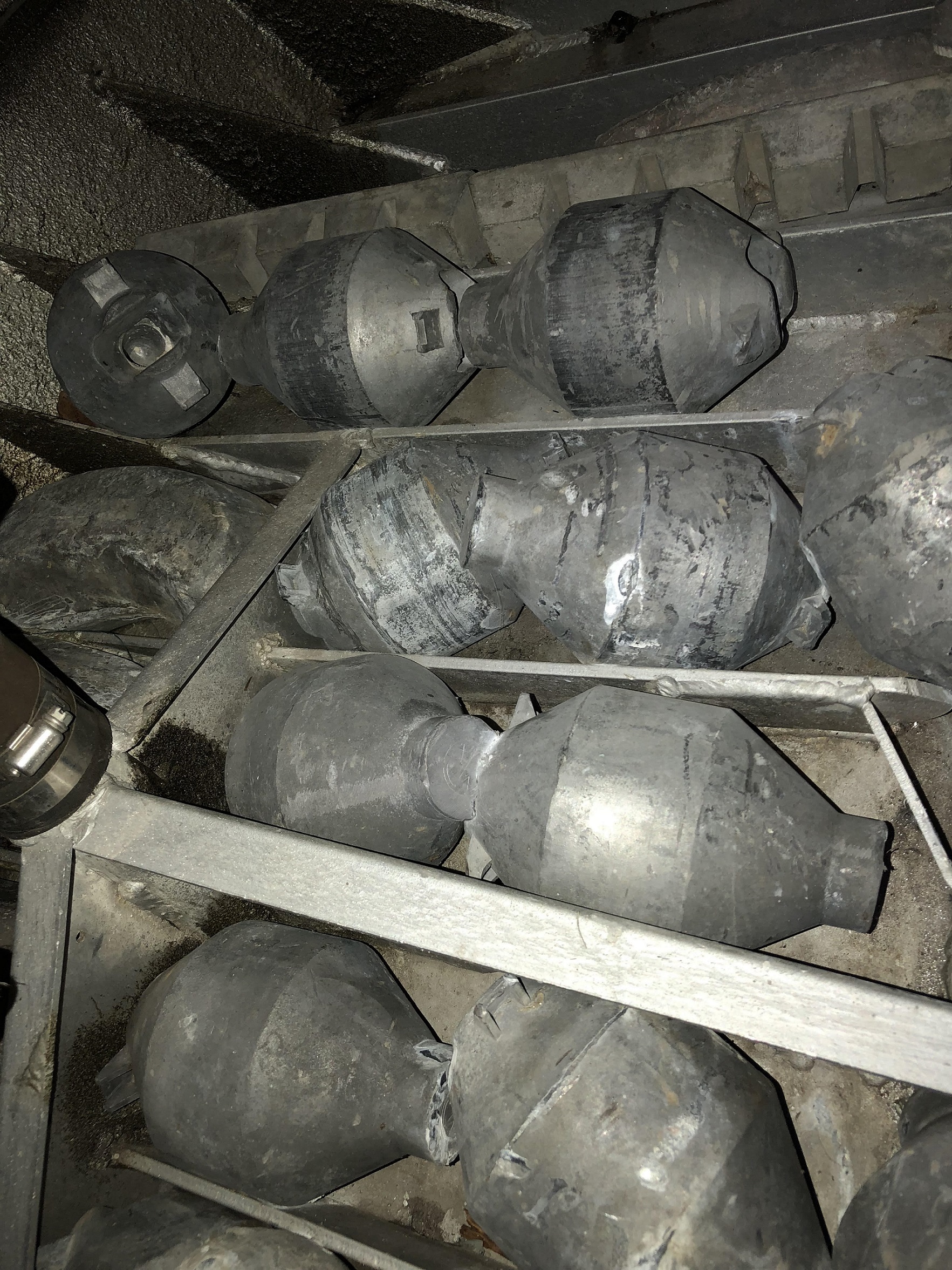

Our 39 Sedan has ballast weight added in the stern by way of lead weights. (see pics)
They have been there going back to the original owner. It appears that either he or Marinette added them. There are somewhere between 80 - 100 of these weights. A few (6 dredge fishies) weigh only 10 lbs each. The others probably weigh 20-30 lbs each. That being said, there is at least 2,000 lbs of ballast that I am hulling around.
The individual that I bought it off of speculated that it was added to compensate for this boat not having an aft cabin. It seems that most 39's are aft cabins.
The boat seems to run well up on plane. I don't have experience to compare it to. The boat sets in water okay I guess as it slants down to the stern just a bit.
Has anyone encountered this before with a 39 or 41 Sedan?
I sure would like to remove this and not pay for the gas to hull it. Maybe replace it with more valuable cargo like gas or beer...

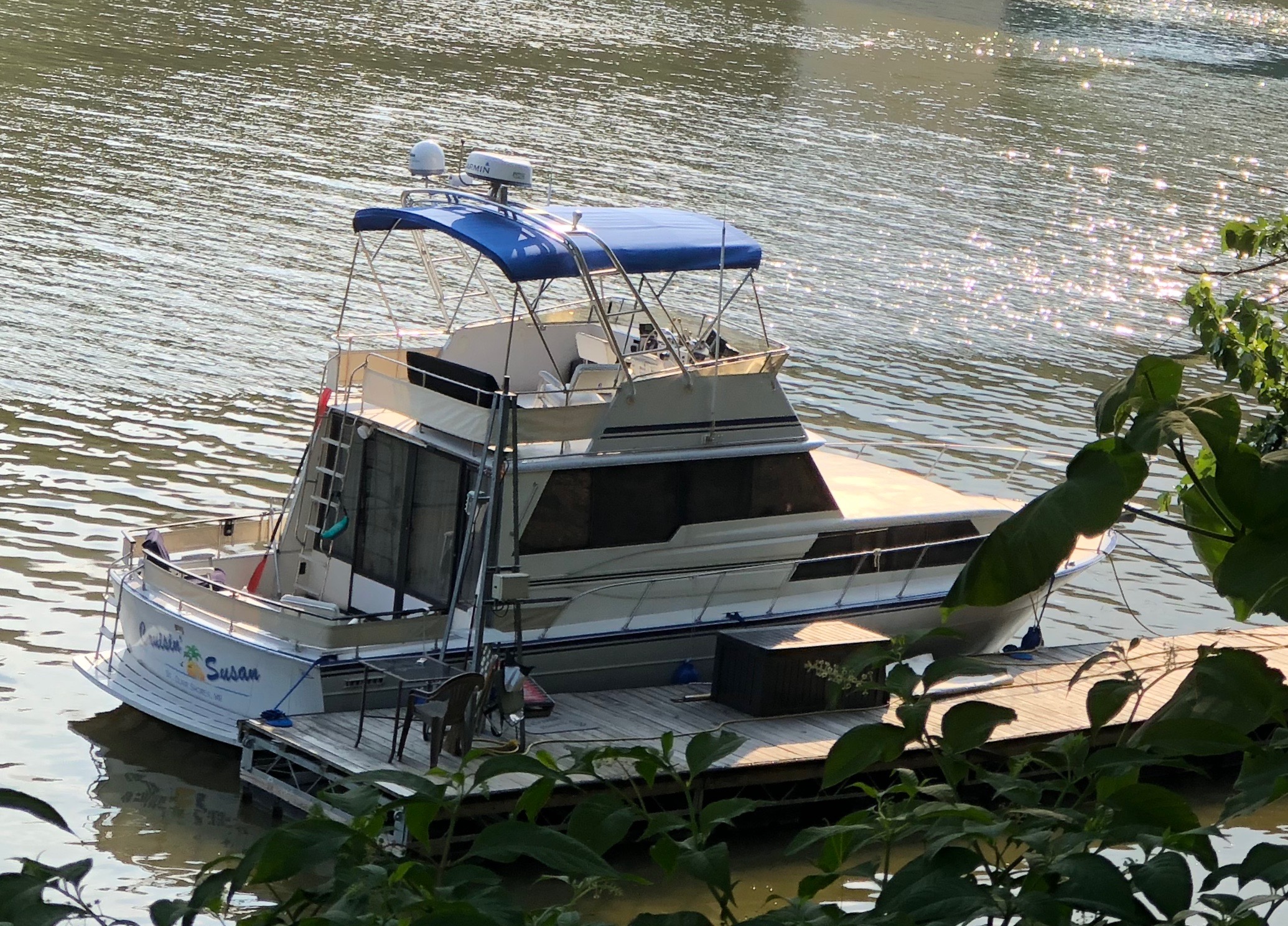

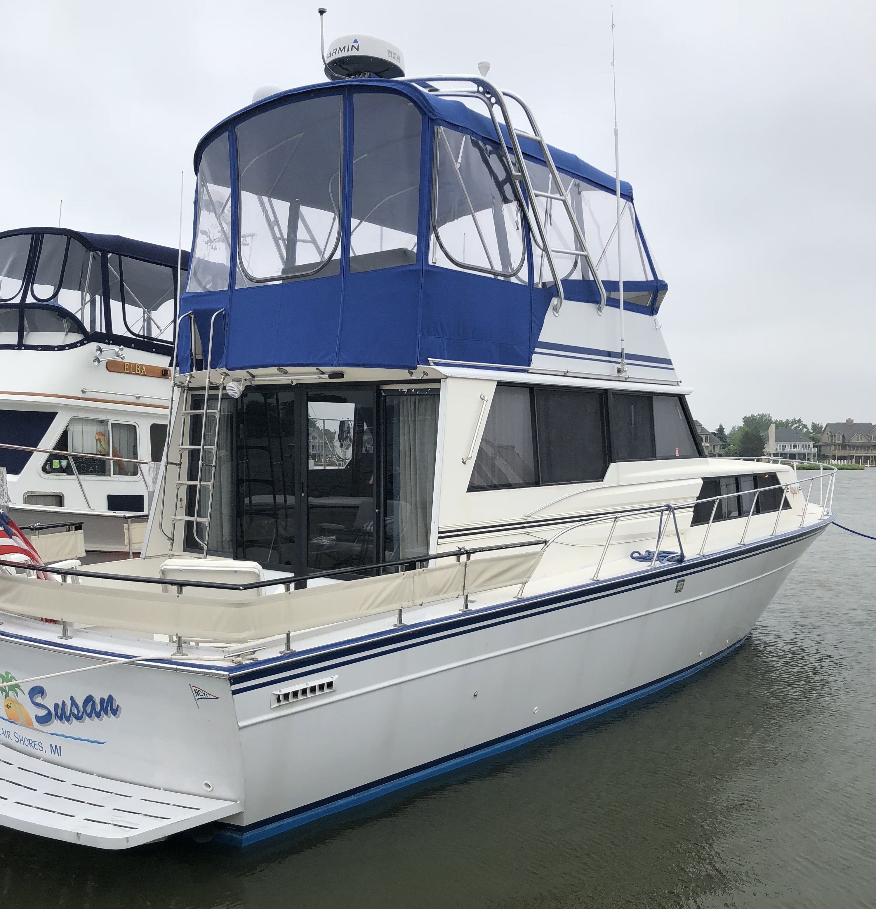

These are the only pictures that kind of show a side view.
I don't know if it shows anything.
