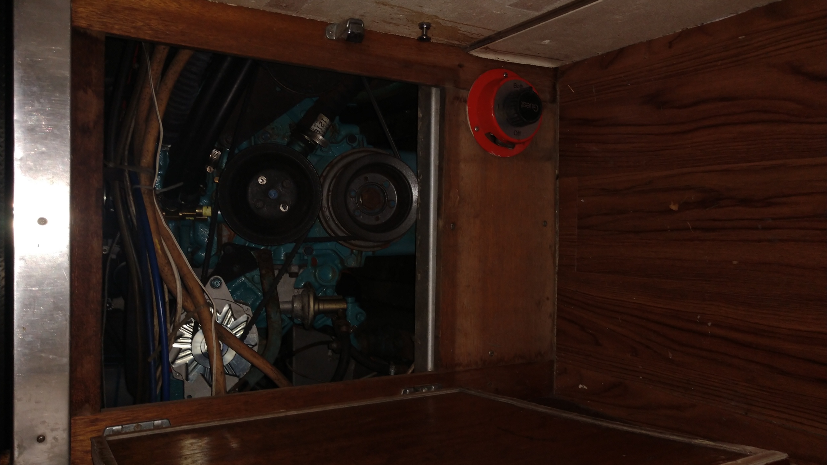

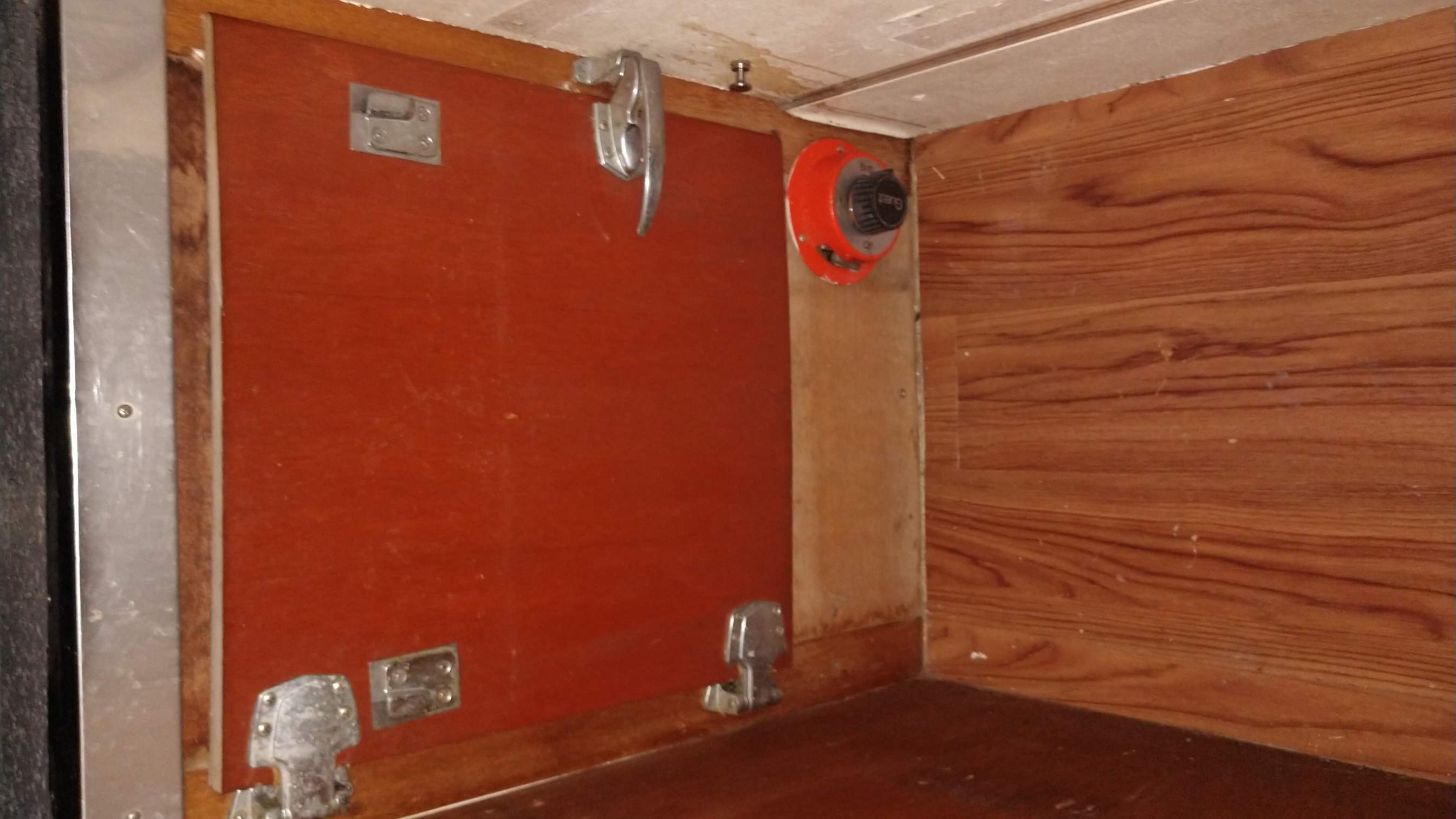

Seef158 years ago I wanted access to the front of the engine. Here was my solution icebox door from an old Chris Craft and steps. The panel will come out but doubtful it will be usable again. Thad
Re: Engine access from under the cabin step true or false
This is also how I get to the from of my single engine Sportsman
