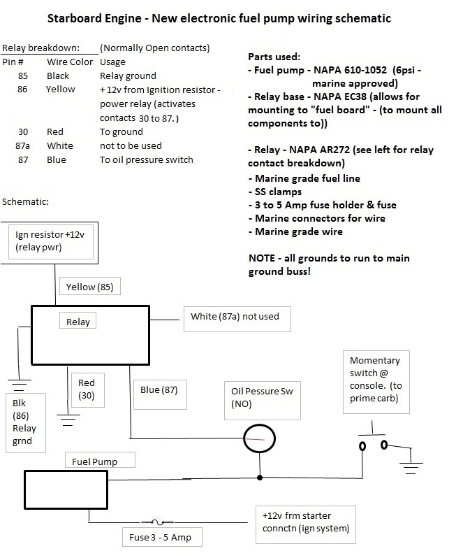

Fastjeff,
Please publish the fuel circuit diagram. :)
Posts: 537
Re: Fuel system upgrades
I worked up a schematic based on Jeff's notes.
--> If this is incorrect, PLEASE let me know and I'll delete it in favor of one from Jeff. I'm kinda feelin' my way here.

This would be good back up to have when the mechanical fuel pump desides to guit.
Good job! Mine's a bit ME vs an EE diagram.
Jeff (retired Mechanical Engineer)

Thanks Jeff!
