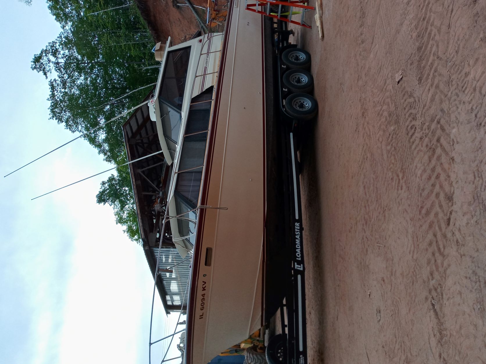

Sitting on better trailer until I can lengthen the old one.
