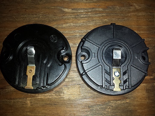

New Rotor on Right
New Rotor on Right
Rotor on the Right is the re-designed on. Instead of a rivet there is not a screw. Also notice the different style of pickup spring and different shape of the rotor contact.

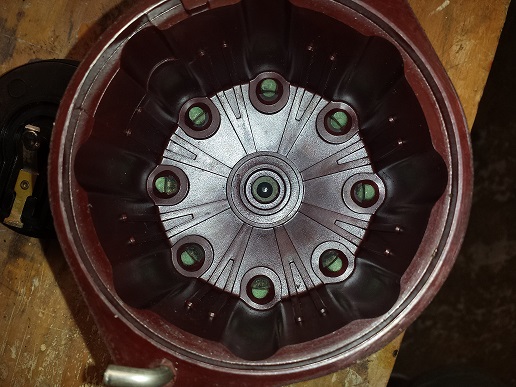

New Designed Cap 617.jpg (35.33 KiB) Viewed 10738 times
New Cap.
STBD engine 5th Season
Dist. 6 17 5th season.jpg (34.71 KiB) Viewed 10738 times
Latest photo of Dist. on Port engine (Picture is named wrong... senior moment)
Both engines started from cold starts quickly. Smooth idle and no missing or hesitation all the way up to WOT (Which is around 3,300 rpms with my loaded boat with slightly over pitched props.
