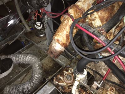

Do you guys think its reasonable that the clog would have caused the damage I am seeing on that side of the engine (port)?
The photo of the rusty metal is just under the carb on same side that the exhaust hose ruptured
Clearly, I can put it back together and run it but the heat mark on the carb manifold is giving me caution. I don't want to do any more damage if there is something else I should replace for good measure. That side has run hotter since I got it a few months ago.

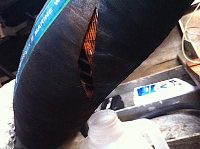

I had the issue with the exhaust hose melting and blowing out (see earlier in the thread) and at the time I was really surprised at how forceful the steam and water pressure was as it ripped open. I actually watched it come undone after the engine was brought down to idle.
I found some delaminating on the other side in the same area so I replaced both hoses. and got a stainless steel bend to take that first, really hard bend as it came out of the manifold. The old hoses were really maxed out (as bent as they could possibly be) so the exhaust guy told me that it's best to get the tight / high temp areas done in stainless. I bit the bullet and got them at 90 degrees so I could route my hoses to the wall and gracefully level them with a more stable system than the old straps.

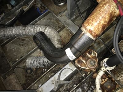

After removing the old deck for replacement, I addressed the exhaust hoses and leveled them (NO DECLINE - JUST LEVEL) but the hose needs to drop 2.5 inches to make the bottom of the exhaust manifold. The stainless sharp bend made the drop a bit less but still ends up being 2 inches below the proper height. I fired her up and after a very short time, my fitting was spraying water because I didn't fully clamp it, it was just pressure fitted for testing.
The back of the manifold came with what looks like a 30 degree down angle piece on it, making the edge of exhaust manifold assy start AT level and at a 45 degree slant. Any hoses start at a negative and need to push the water out.
Shouldn't exhausts be relatively free of obstruction?
Is that down piece supposed to be there?

I think you may like it better with your steel 90 being more of a straight shot to the side of the boat say a 45 or less so your long hose to the back will not have the big bend in it ?? One side of mine was metal in the turn and the other straight hose to the back . I now have the metal turn outs on both sides. the 90 just looks like the hose is going to have to bend 90 back to get to the back of the boat.

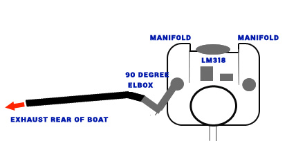

They wind around the gas tank that is in the center. They exit the rear of the boat. Its just the 20 degree elbow from the manifold makes the exhaust go below water, requiring the engine to force standing water out, under pressure.
The 90 degree stainless lets the hose curve around the tank much more gracefully.
The only solution I see here is to rooster the stainless elbow up a bit so the standing water is less, requiring less pressure to clear the line (see attached example) - anyone who smoked a hookah / similar methods will know what I mean :P Making it totally level doesn't seem possible with this setup
