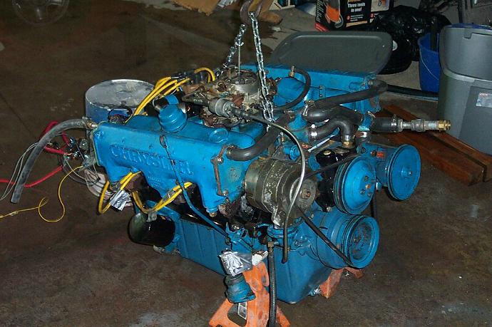

Re: EFI Repower
Damn right they should be test run on the shop floor. I ran mine for at least a half hour.
