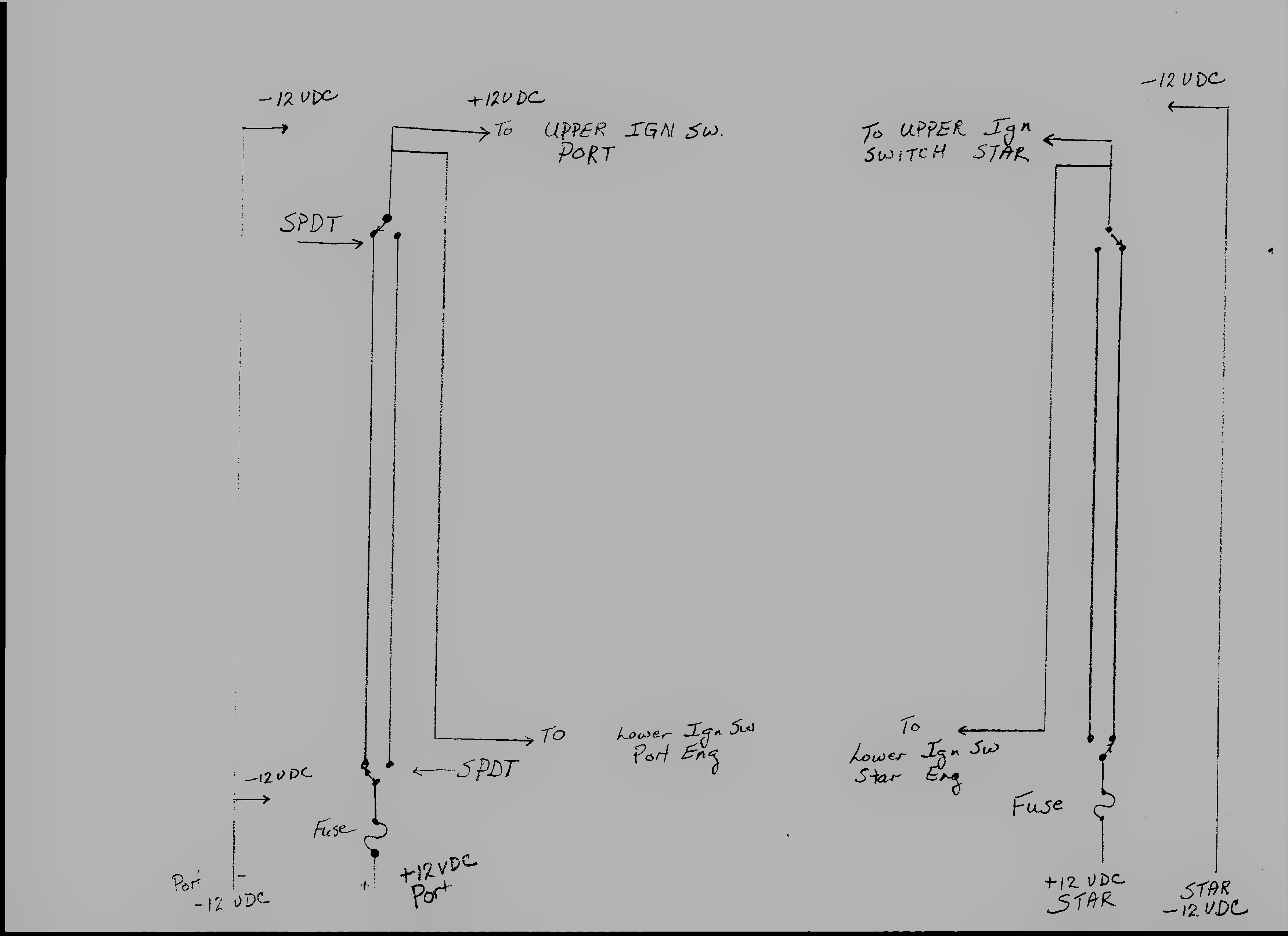

You can put a note there to remind yourself or wire them like this. This is how a 3-way switch is wired. The only thing is there will be no set on or off position, but you can turn it on or off at either location.
