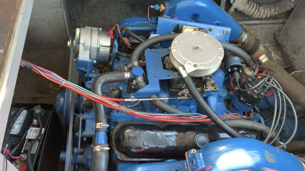

Yes, I am amazed! In about 20 minutes, Fastjeff had her running like a scalded dog. Having determined that it was 180 deg out, after getting the engine close to TDC, Jeff rewired the cap (from memory), and lifted just the rotating shaft of the distributor, moved that 180 Degrees, and dropped it back into the slot.
First turn over, it fired, and about the third turn over it ran beautifully. After it heated up, and a small distributor adjustment by ear, it's running like a clock!
