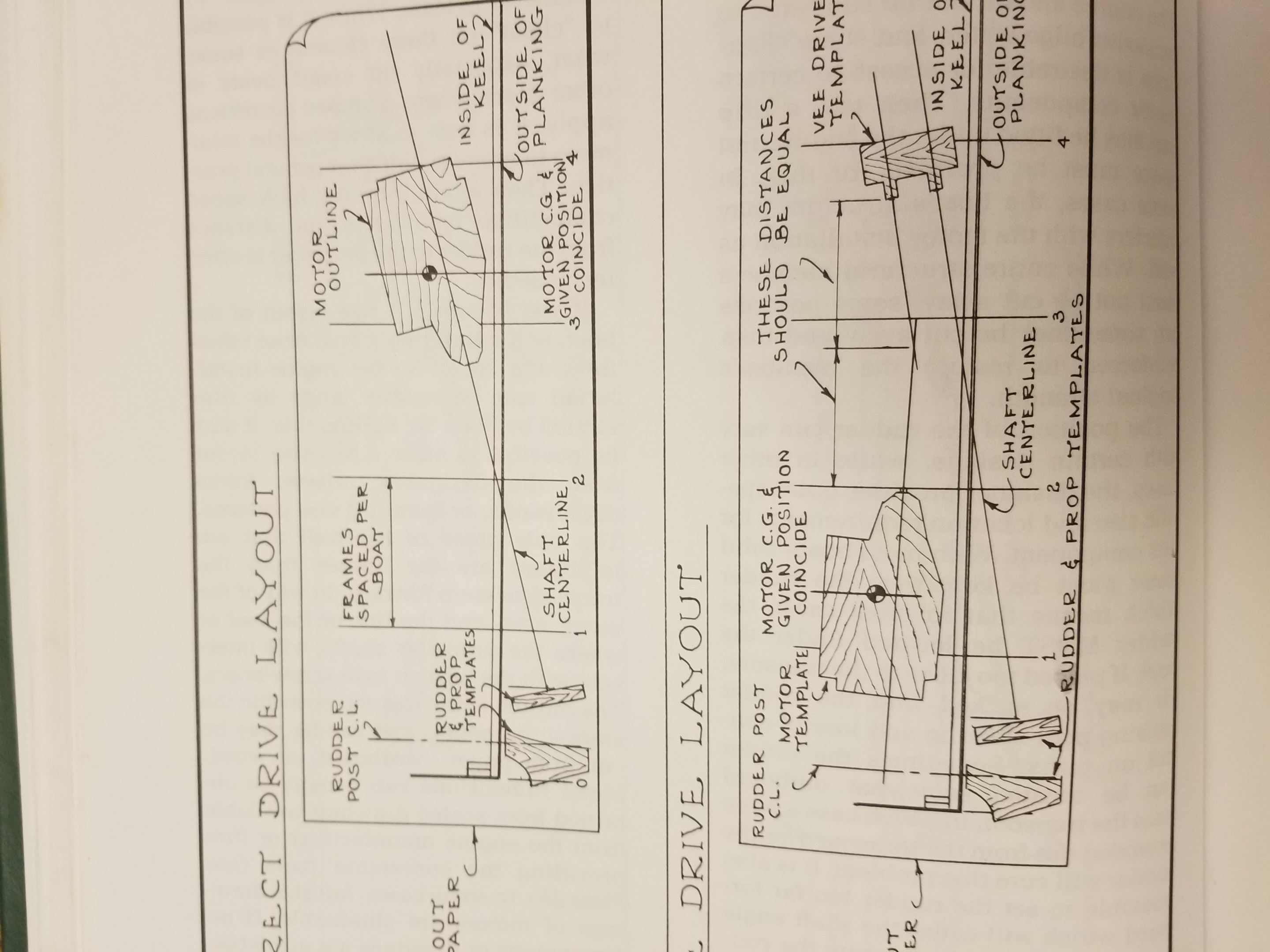

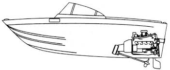

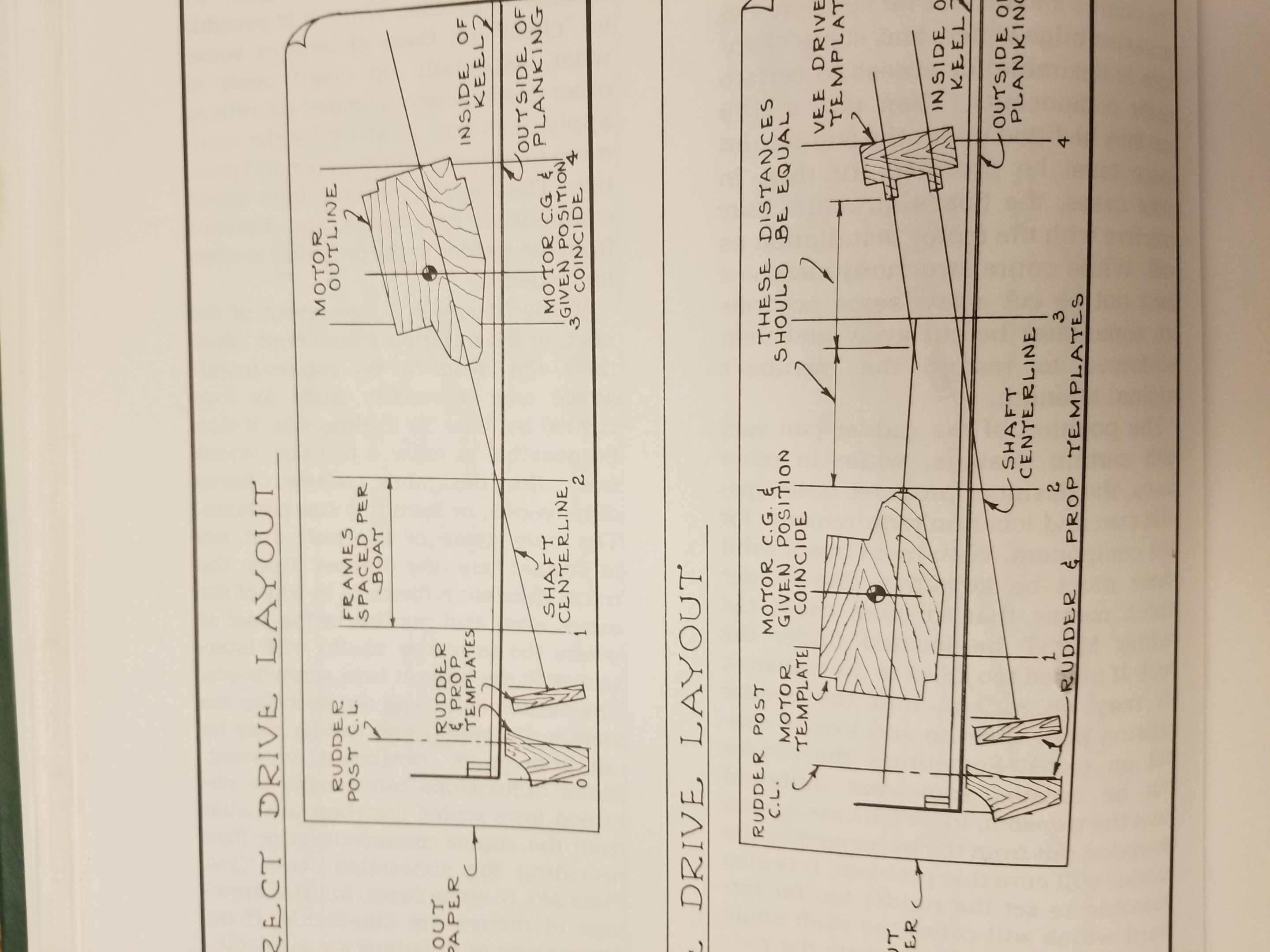

Re: V drive question
The only BigMs that (to my knowledge anyway) came with v-drives are the houseboats (a/k/a "river cruisers"). With a V-drive the front of the engine faces the stern so the output shaft faces forward. The actual v-drive has an input shaft on top mated to the engine/transmission and the output is attached to the propeller shaft.
I tried to attach some images so you get the idea, but if you google "v-drive boat" you will see similar images.
The advantage to a v-drive is the engine can be placed farther aft though in most designs that isn't really an advantage. Inboard houseboats are usually v-drives as are some ski boats.
The
s had velvet drive transmissions so someone may be confusing that with the v-drive.
I hope this is helpful.
