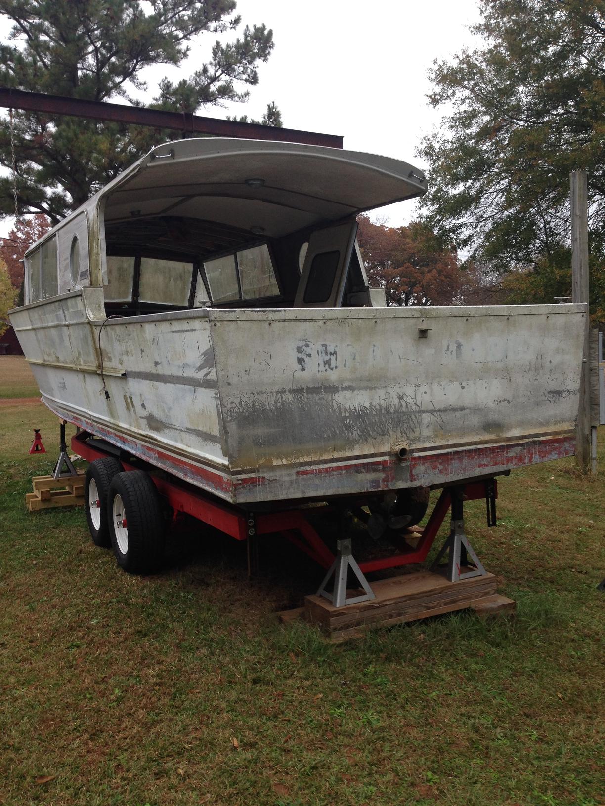

Some more views of the 59 on its trailer. This is a single prop.

Look at my post above with the specs listed. Twin 6500lb (6 lug) axles are plenty for that boat. I haul my 63 with this setup with no problems .
Big BigM 's Rule !!!
MetalHead
Posts: 269
Re: TRAILER PURCHASE INFO NEEDED
Post by MetalHead »
Clarification ,
Hauled my 59 28 footer with twin 3500lb axles without an issue so 6500lb axles should be overkill since I use those to haul my 63.
