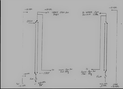

Three way switch is easy, putting the drawing on here is hard. Send me a message if you want to do this and I will try to e-mail the info to you.--Ed

3 way switches for control from top or bottom
Posted: Tue Sep 20, 2016 12:39 am
by Busia
Three Ways
Three Ways
You will need to add two wires and two switches for each engine. Wires will go from lower to upper helm, and switches need to be single pole, double throw. Double pole are common, will work fine, you will just have spare contacts unused. Do not get center off, or spring loaded switches. Just four SPDT or four DPDT switches. Single engine will only need two. Then you can start or stop from top or bottom. ( if the picture shows up )
