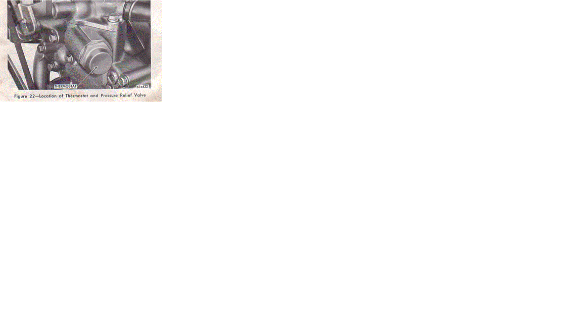

so if you look at the manual for a 67 318 here is what the photo says the thermostat is. The one on top that we would all call the thermostat is called a pressure relief . So my boat is a 73 and only has the odd looking 100 plus dollar thermo but if you seen the post fastjeff made an aluminum plate and a trip to your local parts house and you will be well under 20 bucks. I called Marysville Marine and they confirmed they can no longer get the odd screw in type. ( also found a company making this style but for aircraft and about 350 bucks.) If anyone has any input I would love to here it because we are at the stage of putting the old stuff back in and running it till it breaks.

The picture you show looks nothing like the thermostat housing on my motor and I wouldn't think yours would differ from mine..

The photo is of the 67 318 setup . Mine is a 73 28ft single 318 and is the same as yours.
